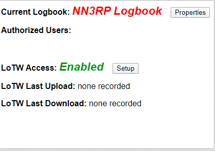

I am new for about a week at this software....little by little I've made to work. One issue that I encountered was that, although set to automatically upload, nothing was being sent to QRZ. Whenever I did a manual upload via the "QSL Manager," it was noticed an error: QSOs date/time is outside of the logbooks date range.
Little did I know that I had to go to my QRZ account and modify that entry! It was way back in time.
If you ever run into this issue, here are the steps to follow:
Adjust your logbook's date range:
Open your logbook
Click on SETTINGS then PROPERTIES
Adjust Start date to first QSO date by clicking inside the Start Date, if needed. A calendar window pops up.
Adjust End date to a future date (licensed expiration perhaps) by clicking inside the End Date. A calendar window pops up.
Save is way at the bottom of the page.
Perhaps set yourself a reminder for that End Date!
I hope this is of help to anyone noticing this error.
