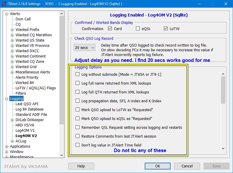

Jith,
You noted using JTDX, but did not advise if you are also (or not) using JTAlert.
If you are using JTAlert there is a page of settings that impacts QSOs being sent into Log4OM V2.
I've attached screen-clip of tic boxes that you do NOT need to check if using JTAlert.
