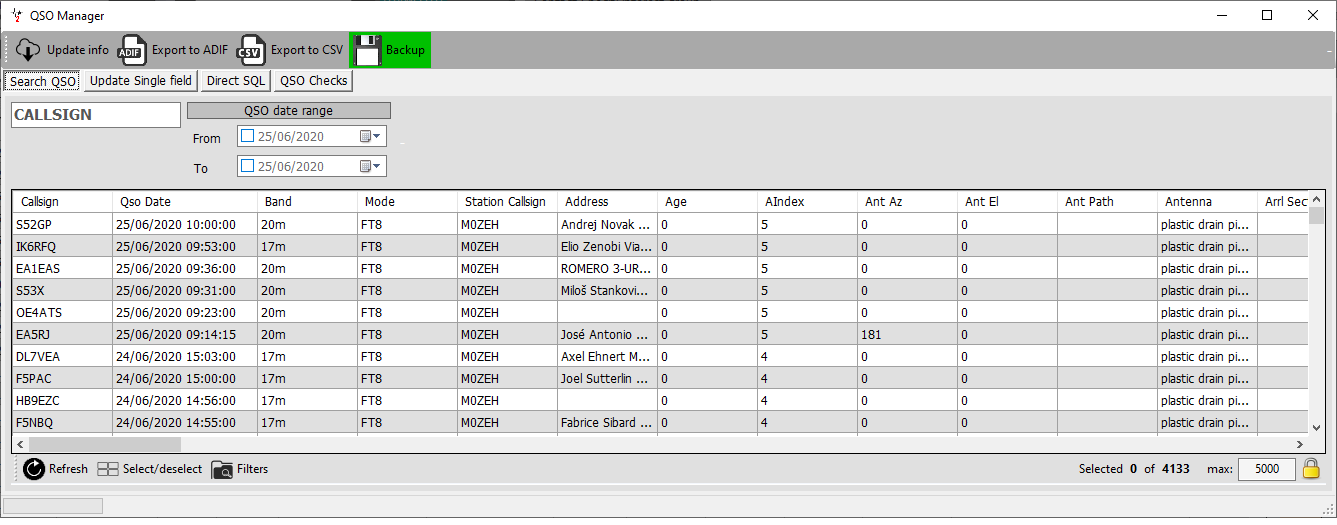

I noticed the Date/Time update is missing in my QSO manager.

Re: Import adif v2.2
M0ZEH wrote: 25 Jun 2020, 12:45 I think your misunderstanding me. I am talking about qso manager. I have no date time tab in qso manager.
Ah! TAB I missed that and assumed you meant column
Check you email from me with a new download

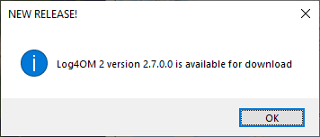

Thanks for the new version. I get the attached message everytime I start log4om.
I now see the Date/Time update tab. The hint doesn't finish sentence and ends with 'which'.

M0ZEH wrote: 25 Jun 2020, 13:35 Thanks for the new version. I get the attached message every time I start log4om.
Go to the first tab in the Settings/Program Configuration menu and uncheck the 'Notify of updates' (Or similar)
