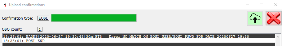

I am receiving
[EQSL UPLOAD] Error: NO MATCH ON EQSL_USER/EQSL_PSWD FOR DATE 20200627 19:36
I am certain that the user, password and QTH are correct. Possibly something to do with the date format?
EQSL Upload Error

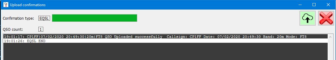

Well here is one that I just uploaded a minute ago without issues so its not a Log4OM error or an EQSL issue
So something is incorrect at your end

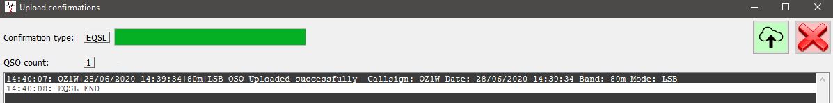

I just did a single upload to EQsl and it worked FB similar to Terry's results. Image is below.
The reply from EQsl says: "No Match on EQsl user/eqsl pswd ... "
I'm not sure, but that could be a login / password error message (still) from EQsl. I know you have checked that, but could be worth another review.
As for date/time display in Log4OM V2 ... that is controlled by you and how you have set up your date/time display in the Windows O/S.
Log4OM (V1 or V2) do not set how time/date are displayed. We take what is provided by the Windows O/S.
If you change that, make some Q's and try another upload and see what happens.

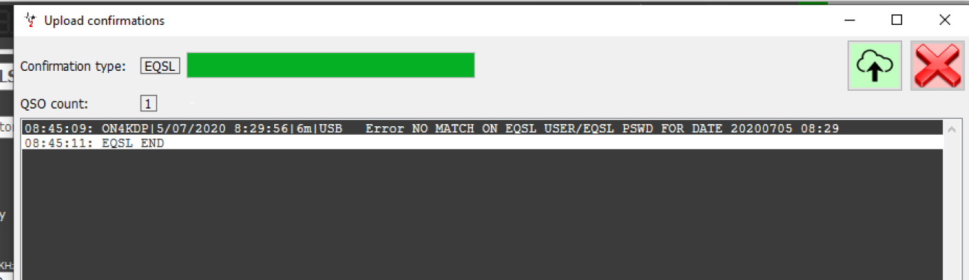

I have the same problem.
I even have changed my pasword and stil it gives the same message.

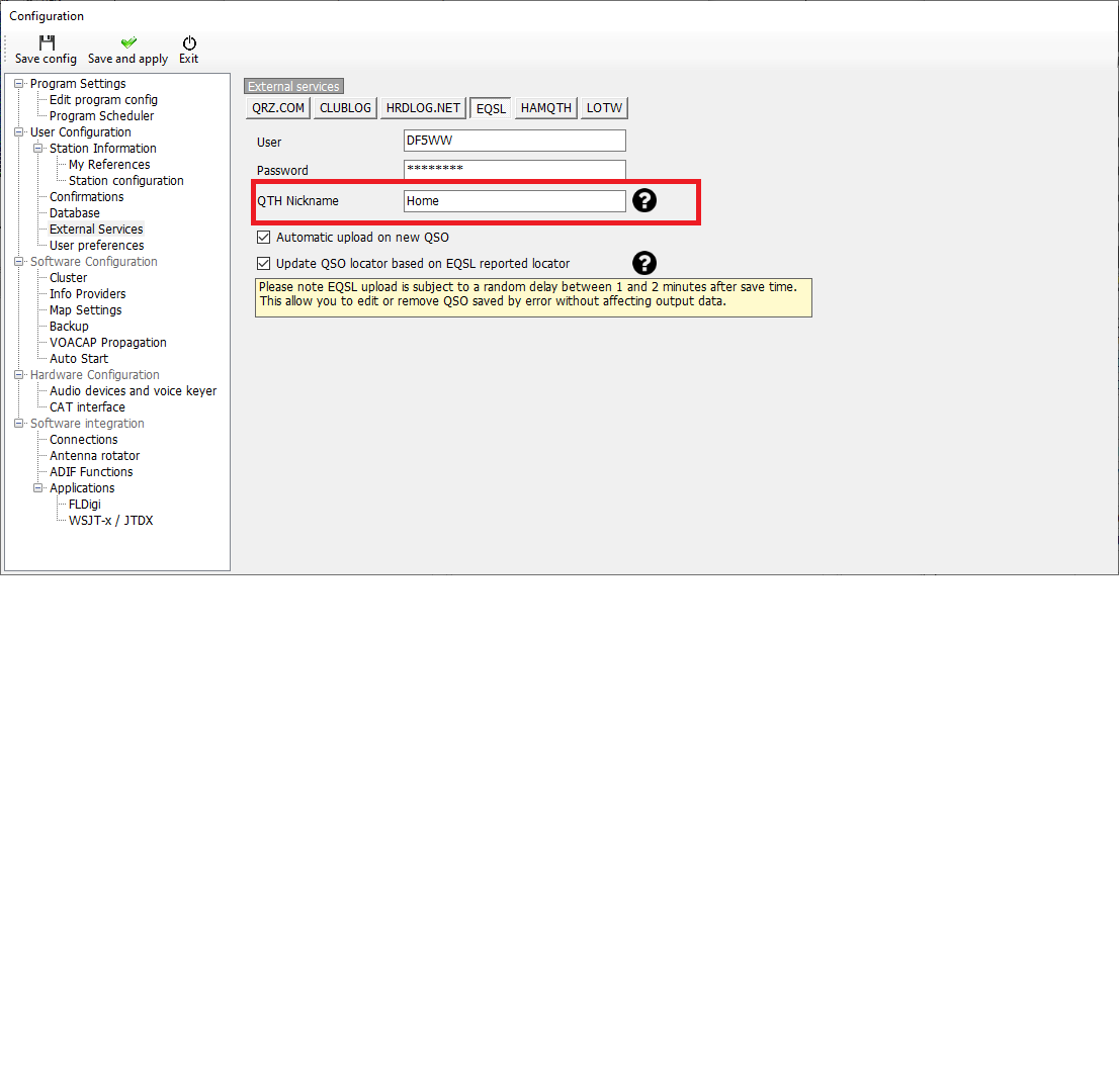

By the way, have you both your QTH Nickname setted correct in the Log4OM settings ?
It must match (upper- and lowercase) exactly or upload fails. For your correct QTH
Nickname check your accounts site at eQSL.
