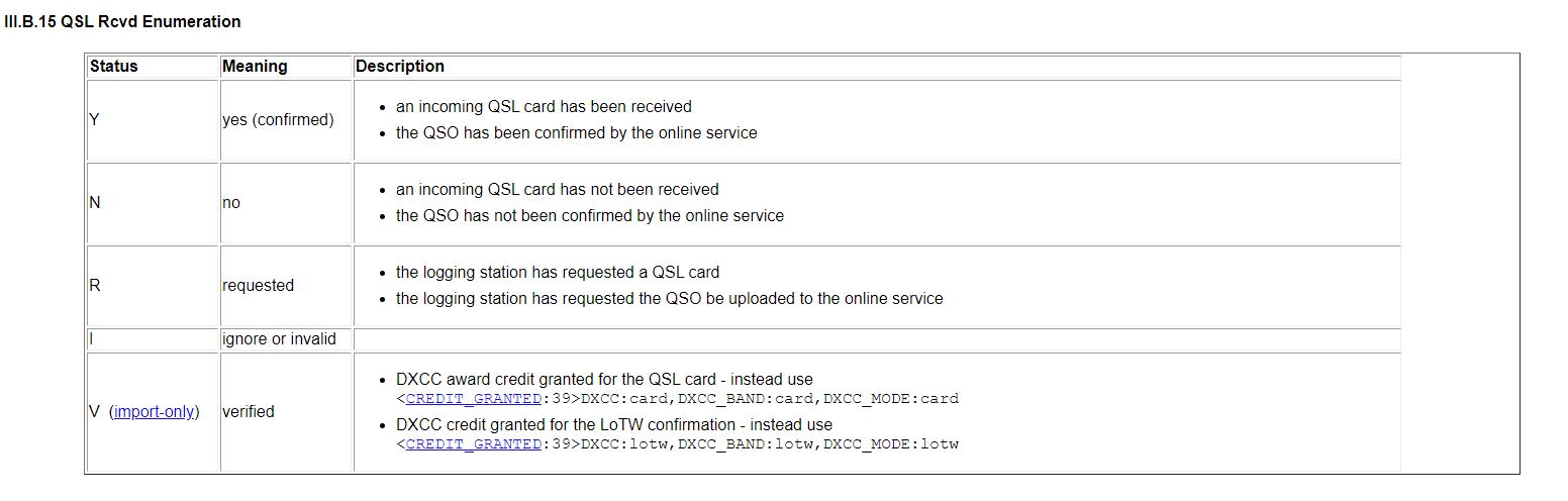

Yes Mike is correct and that is the way we DISPLAY it but the export to ADIF conforms to the ADIF standard as below
https://www.adif.org/310/ADIF_310.htm
You will note that V is now for IMPORT ONLY
When a LOTW confirmation is received by LOTW and matched the received status Yes makes it instantly and automatically Verified
