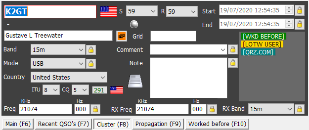

I tryed to insert K2GT on my log4om
the corret country is Hawaii OC-019 and not USA
see below
73 de Tiziano IU3CYV :roll:

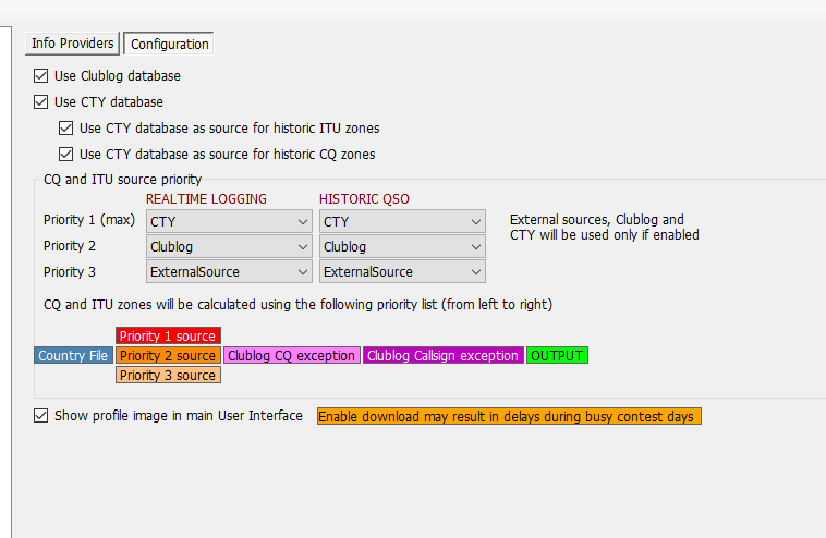

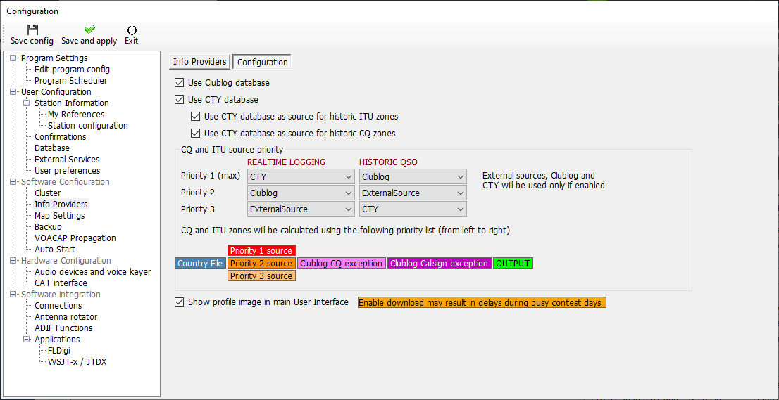

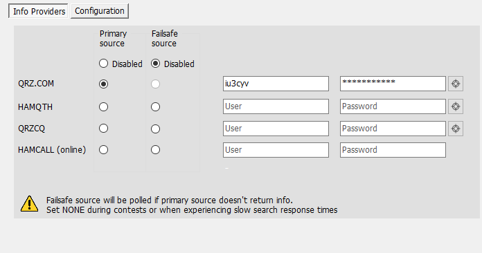

hello Juergen my first info provioder is qrz.com
Can you show me your correct configuration?
see below

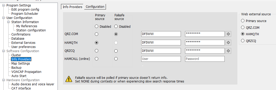

Hello Tiziano,
in my case this is working ....
But in my case i have HamQTH as preferred source. If you have QRZ.com as preferred source you need a payed
account. If you not a payed subscriber you will not get full information. That´s the reason that nobody can find
me longer on qrz.com.

Tiziano,
Your not a paid xml subscriber to QRZ (Just a Ham Member) you wont get full look ups unless you pay QRZ, try HamQTH which is free
