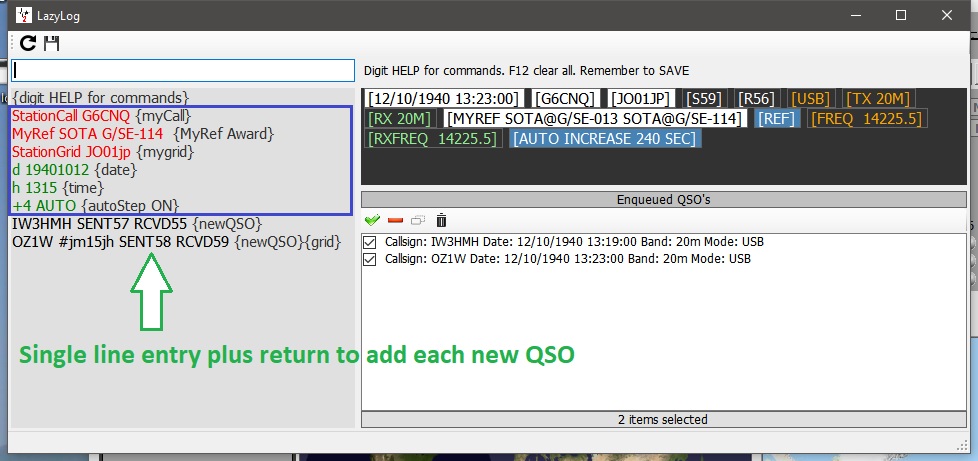

Having read your comment on the QRZ forum "Lazy Log" utility is so user unfriendly" I revisited your post here.
1. CAT has no effect in Lazy log?
2. Resetting the date, time, band, mode etc just requires a fresh entry or an auto increment of the time?
3. How much simpler than typing f 14125.555 can we get?
4. The right hand pane already displays the QSO's entered and the top pane full detail?
The Lazy Log style of manual QSO entry was requested for years by many users and so far the feedback has all been good so I cant understand why your having so much trouble and wanting to construct CSV files and then have to convert those files to ADIF before importing the ADIF into Log4OM?
The commands outlined in blue only need entering once and the QSO's then are entered by a single line of text followed by pressing the 'Enter' key on your keyboard.
Mistakes in entries can be deleted before saving the QSO's to the main log
Admittedly there is no provision to enter comments but that can always be added at some future date if we get enough demand for it.
