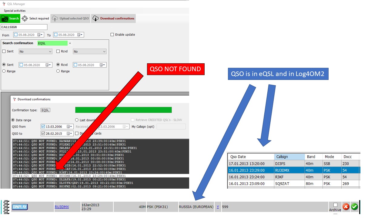

i am trying to download eQSL confirmations, but for many QSOs appears QSO NOT FOUND.
The QSOs are available in eQSL and exists in Log4OM. I've attached a picture of an example.
What could be the reason ? What could i check to figure it out ?
eQSL confirmations download failed: QSO NOT FOUND
- QSO_NOT_FOUND.jpg (160.47 KiB) Viewed 2201 times

Re: eQSL confirmations download failed: QSO NOT FOUND
Ok, but my problem occurs with Eqsl, it shows: "PSK (PSK31)"
Is this wrong?
What is Log4OM expecting ?
I am not sure, what i have to do now.
Is this wrong?
Log4OM is expecting nothing, we record the mode correctly when you log a QSO
The main mode is PSK and one of the many sub-modes is PSK31 (See the official ADIF field format below)
What has happened is that the other station has recorded the mode as PSK31 so when you download the eqsl file the mode does not match that in Logh4OM which has the QSO recorded as PSK (Looking at the date of the QSO this was probably from importing your log from another program.)
So you must select all of the QSO's in your log which say Mode = PSK (Use the QSO manager and filters to do that)
Then do a bulk update using the single field update in the QSO manager to change the mode to PSK31 - This should take a minute or so!
When you have done that try another eqsl download
