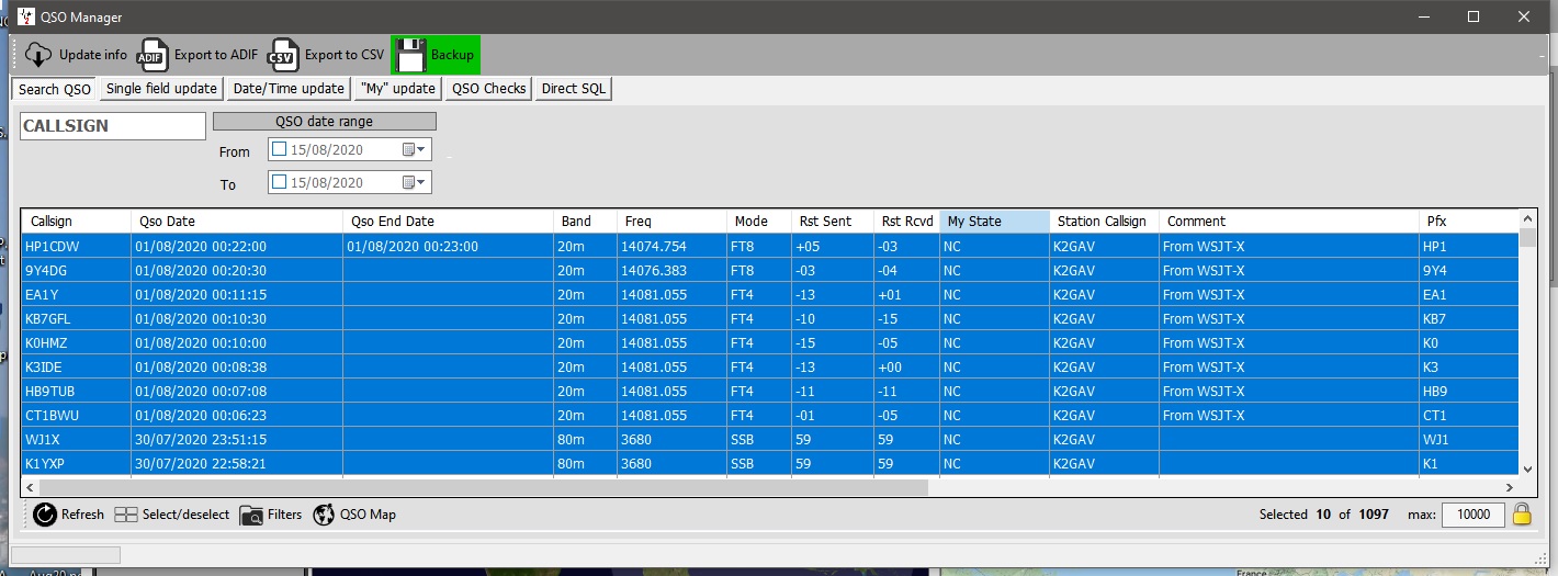

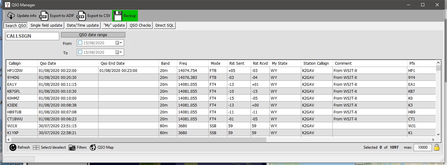

I just tested this on some of your QSO's that were in my test file and it worked 100% OK
Are you sure that you had not checked the box 'Clear field'
The selection before editing
After the edit
