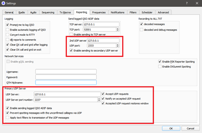

6. Ensure that all other Log4OM and WSJT UDP settings correspond EXACTLY to the Log4OM user
guide

In the WSJT File/Settings/Reporting tab complete the settings outlined in red in the image below.
• Click OK then close both programs and restart
