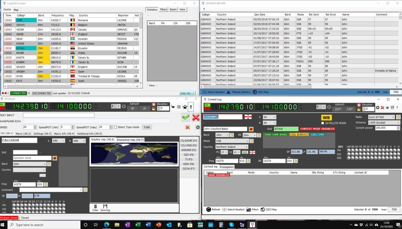

There's a "Contest entry box" which can be detached and is not limited to contests only. Check Contest/Contest in menu. Perhaps this will help.

You could of course reduce the window size to that of Win4Icom suite and possition at the bottom just like Win4Icom suite!
Or do as suggested and use the contest or winkeyer windows as below, the options are varied but I dont see a reason to rewrite the UI?
Capture (FILEminimizer).JPG (181.33 KiB) Viewed 3814 times

Now then..... the idea of using the Contest Entry or WinKey forms and position them in lower center screen makes a LOT of sense. Below is how that looks at my station. (This is a 2-monitor arrangement. The left screen is centered above my radio.)
The right half is the familiar Log4OM main screen, set up to provide me with information about the contact. On the left side I have positioned the WinKey window in the perfectly IDEAL spot for data entry, directly above my radio. Just a minor shift of my eyes takes me from the radio to the data entry window.
So the problem would seem to be solved, right?
Unhappily, NOT.
While the data entry point is now EXACTLY where it ought be, the information being entered is not linked to the main screen on the right.
Note in my screen grab, I have entered the call of K7SS in the WinKey window. But the main screen on the right reflects information from a previous QSO on a different mode.
Ideally, when I enter a call in the "WinKey" window, the "main" screen at right should behave as if I had entered that call over there. (The "contest" entry window has the same behaviour)
