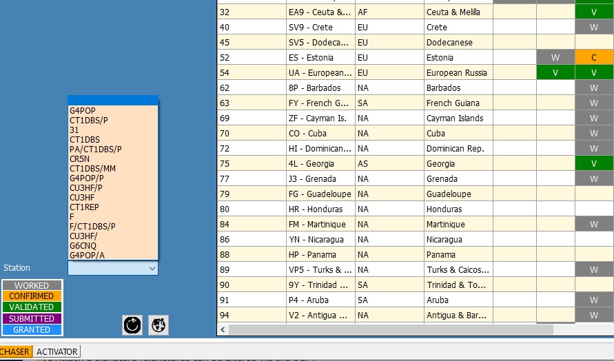

Already there
Select an empty or blank to show all call results grouped
Select single calls to display results for just that call
