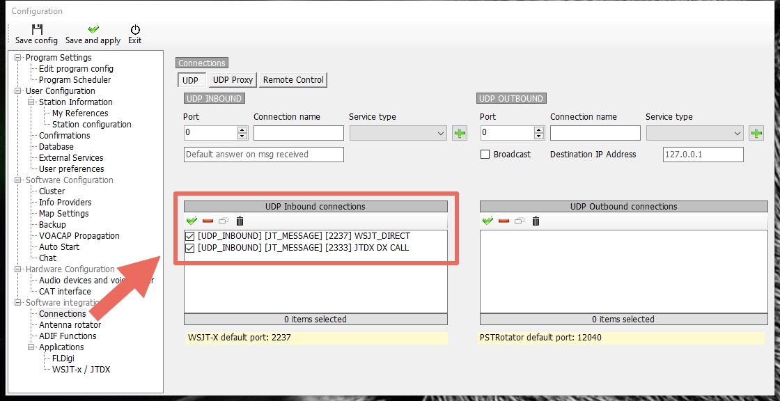

Please find attached my JTDX configuration with Log4OM v2. This has been working for many months without any problems. Please cross-check with your configuration. Please note that I'm NOT using JTAlert. For connecting Log4OM direct to JTDX, you will find a complete to-do list on page 186 in the 2.9.0.0. handbook. Both port 2333 an 2237 are default ports. If these ports are used by other applicartions, you can use any other free ports. Just make sure that the Primary UDP Server port (default 2237) and the JT_MESSAGE WSJT_DIRECT port are the same, and that the 2nd UDP Server port (2333) and the JT_MESSAGE JTDX DX CALL port are the same! In Log4OM don't forget to clock on "Save and apply" after doing any changes!
Log4OM Configuration -> Connections:

Please let us know if this worked.

Thanks very much. It turned out I had used 2337 instead 2237. I blame old age - of the computer screen, not me. :)
