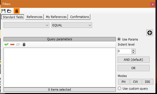

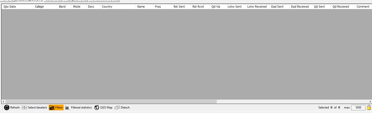

I'm trying to displays the QSOs for which I have sent the LOTW QSL but I have not received LOTW Confirmtion.
I Probably have to make a mistake but I don't see wich one

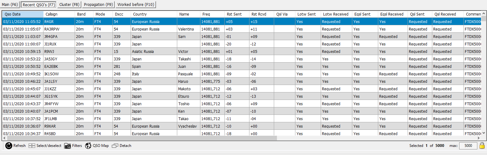

I have my Log like this :
Log4OM QSOs 2020-11-07 102509.png (71.98 KiB) Viewed 3112 times
And I made these SQL Request :
Log4OM Search LOTW non reçus 2020-11-07 102725.png (13.98 KiB) Viewed 3112 times
and the result is :
Log4OM LOTW recherche résultats 2020-11-07 102827.png (16.37 KiB) Viewed 3112 times
Can you help me ?

Re: Search LOTW sent but not received

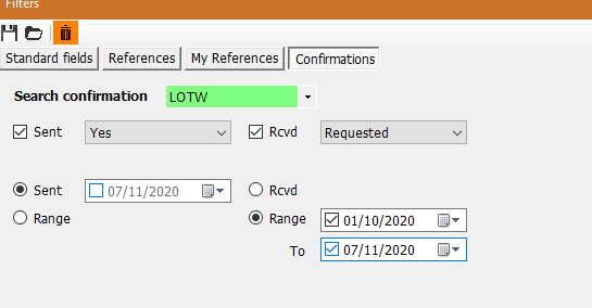

Firstly you need to set a date range for the sent confirmations also, probably the same period
Additionally are there any other filters set as that would conflict?

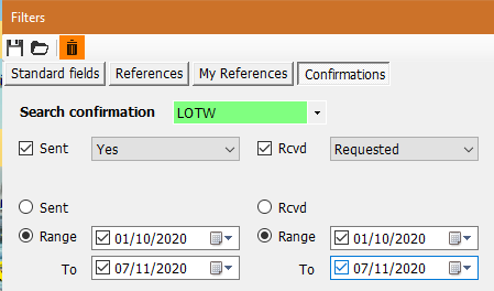

Hello many thanks for your help but
If I set the same date it's the same problem
NO I have no another filters
Capture d’écran 2020-11-07 140031.png (11.67 KiB) Viewed 3102 times
Capture d’écran 2020-11-07 140057.png (10.9 KiB) Viewed 3102 times
Capture d’écran 2020-11-07 140203.png (14.21 KiB) Viewed 3102 times
Email me an ADIF file of you log and refer to this thread please

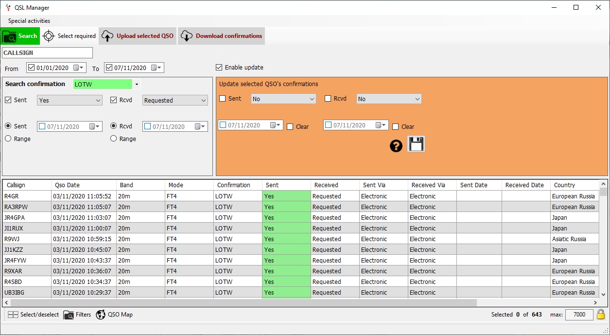

Try using the QSL Manager and use the range dates at the top, I was able to filter for date range fine, see results below 643 QSO's where you sent a confirmation but have not received one apparently? Have you done an LOTW download in the QSL manager yet?

Hello Terry
No I didn’t use the QSL manager
I only look for the filter system with SQL request
I am just looking for the qso for which I sent the qsl lotw and which I did not receive
Thanks again

F6EXV
Posts: 351
Joined: 18 Oct 2020, 09:20
Post by F6EXV »
Hello Daniel
Using the QSL manager as indicated by POP works great.
I have done the same research here, and get the correct result.
