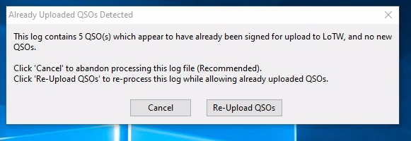

I first noticed this issue a few weeks ago, but thought that LOTW might be down. I'm using v 1.37.0.0 on a Windows 10 computer. LOTW uploads have worked fine for a long time. However, I'm now unable to upload QSOs, as it keeps saying "no records to upload". TQSL Certificate is updated. TQSL QSO date range is 2017-11-25 to 2023-11-20. Records are selected... Here is a screen shot of what I am seeing. My last successful upload to LOTW was 2020-09-06.

I wanted to report back that LOTW Uploads are working again. Turns out it was not a Log4OM issue.
Instead, TQSL running on my computer would not sign and create a file for LOTW upload because it thought that it had already been done for some of the contacts. I didn't realize that TQSL had "memory" for previous activities - but that seems to be the case. Resolution was that I exported an ADIF file with the contacts and used TQSL directly to upload. It complained a few times, but did it anyway.
Now I can use Log4OM again to upload contacts.
