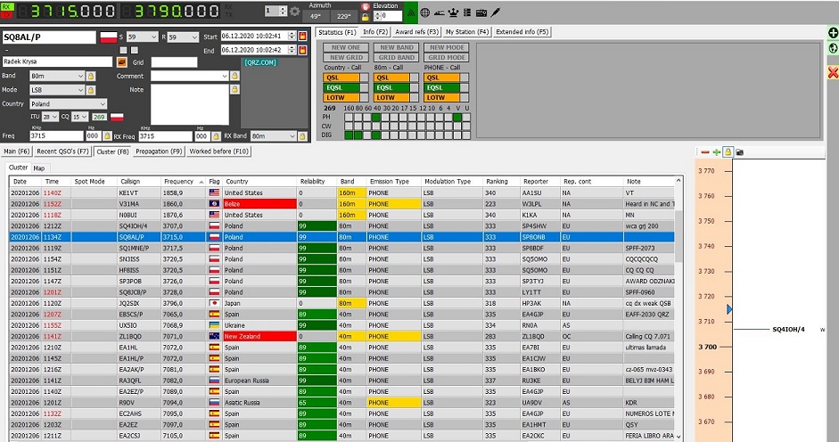

1. I have a confirmed connection, eqsl ticket, but the picture in LOG4OM is missing
2.There are 7 call signs in the cluster from 3715.0 to 3728.0, but there is only one on the right map of the band. why ??

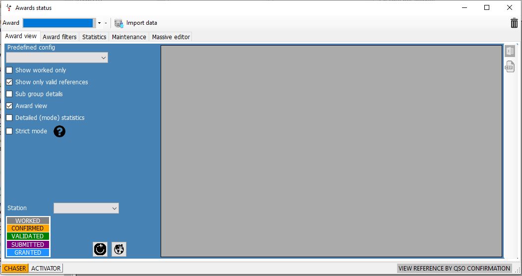

3.Missing awards. I did not find any settings in the manual :(

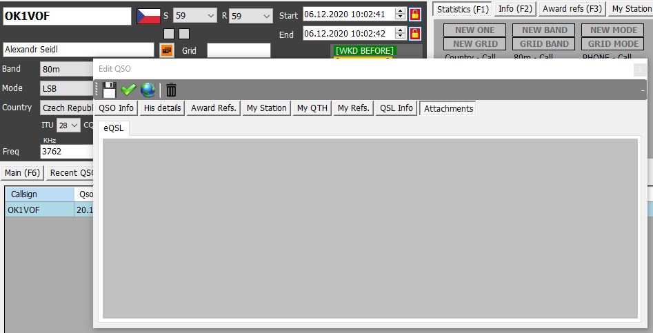

ok1svd wrote: 06 Dec 2020, 13:34 1. I have a confirmed connection, eqsl ticket, but the picture in LOG4OM is missing
You are confusing the on line lookup of bio pictures from the on line website with an eqsl confirmation QSL card which can be viewed from the QSO edit window 'attachments' tab - See our user guide which describes these features in detail!
User guide page 65
Do you mean there is not a list of awards? if so try updating the awards from the 'Settings/update resources' menu

1.Did you mean this window? Yes, the image is missing here.

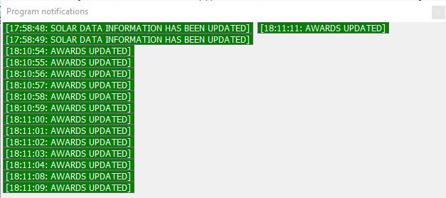

3.Yes, the list of awards is missing. Yes, it is missing even after the update.
