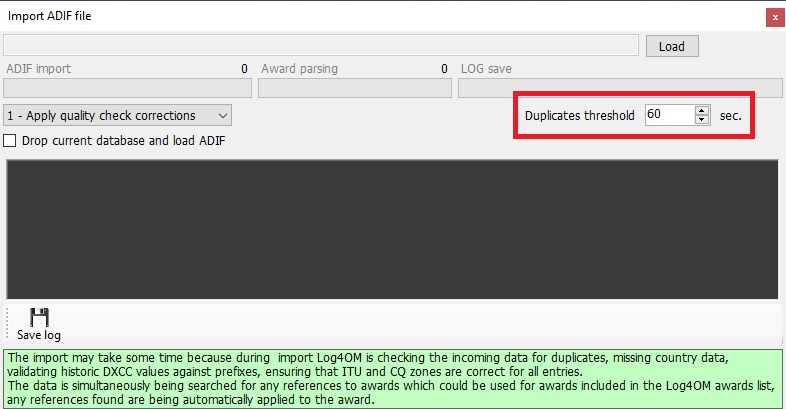

At some point you must have been employing both the UDP and the ADIF monitor systems for WSJT in Log4OM, if you do that duplicates are created because WSJT logs the END time in its ADI log file whereas it sends the start time by UDP
You can easily cure this by exporting a complete log from Log4OM as an ADIF file and reimporting it into an empty database at the import select 'Duplicates threshold' to 30 or 60 seconds which will then consider any smaller time difference as a dupe.

Not sure what you have done but my best suggestion is to create a new database and import a recent Backup ADIF from before you did any deletions but user the duplicates threshold described earlier, that will ensure a dupe free database
