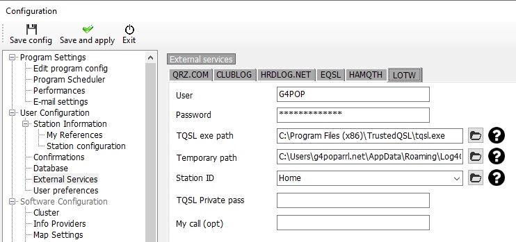

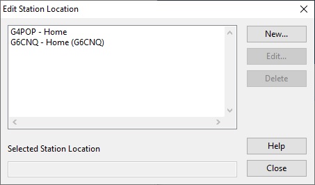

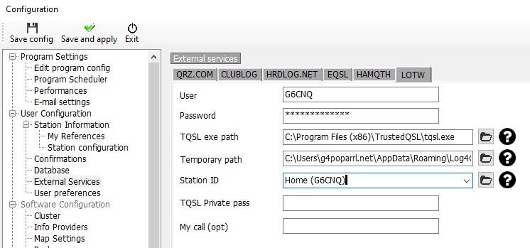

I have two calls and consequently two TQSL certificates as you can see from the TQSL screen shot below
I have to upload separately for each call and this can either be done by using two configs in Log4OM or by manually changing the information in the external services window as below.
