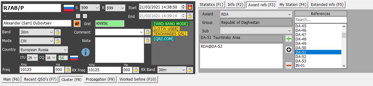

Providing you have recorded the RDA ref when saving or editing the QSO as below then the Award status will be automatically reflected in the grid view
If the award ref was in the cluster notes and you selected the station from the cluster then Log4OM will auto fill the award refs
