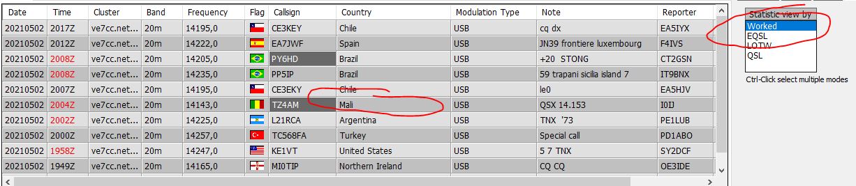

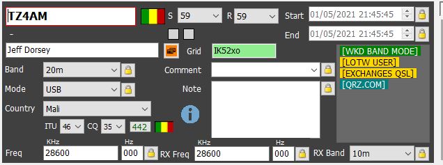

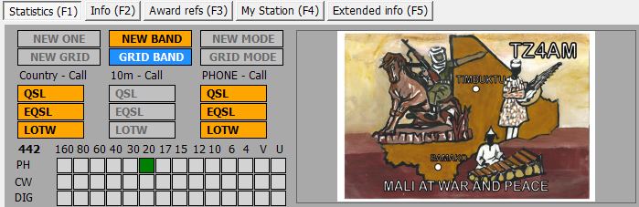

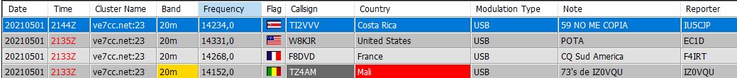

I am attaching photos
Max IK0TIX

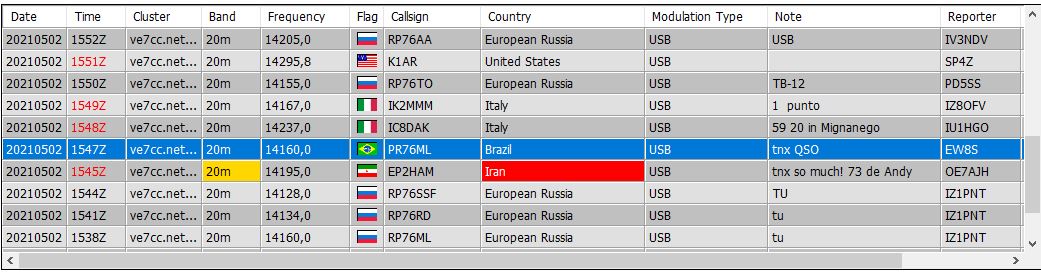

Hi Terry, thanks for the answer
I try it but nothing change, this time with Iran:
Max IK0TIX

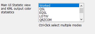

Hi Terry, I solved it and you were right but I didn't understand which cluster filter you were referring to.
In the attached image I used the correct one. Now everything is ok but something no normal happens anyway. When I close and reopen Log4OM, the filter sets me back to LOTW instead of WORKED. Some advice?

Max,
Filter setup is at: Settings / Program Configuration / Confirmations ... once you make adjustments be sure to tap "Save and apply"
