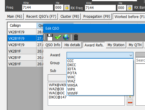

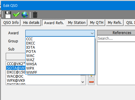

OK - well I did that... I worked my way down all the Resource updates
I also exited and restarted Log4OM
I also tried an experiment, export one QSO and re-imported (changed time)
But the 3 QSOs I had with VK2BYF/9 and the new one I just tested still do not provide SOTA in the list of awards. It's not required in the other two but still no SOTA to choose from.
Other QSOs with VK2BYF (i.e. no /9) in other places, do have SOTA in the drop down list.
So I changed a /9 QSO to have no /9, saved exited L4OM and restarted,,... still no SOTA

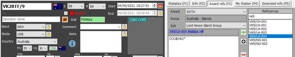

BTW - you have VK2BTF/9 I had VK2BYF/9
If I start to create a new QSO with VK2BTF/9, I have SOTA, if I start to create a new QSO with VK2BYF/9, no SOTA

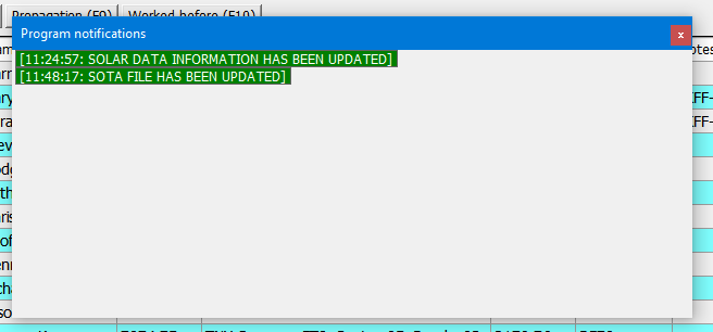

I was just following along on your thread and just completed the SOTA update that Terry noted above after some changes/updates.
I then put in vk2byf/9 and was able to find SOTA vk9/lh-004 without any hiccups.
When you did the SOTA maintenance update did you wait until the round banner appeared in the Main UI near the "note" label? If you then were to click on that button/banner it would indicate that the SOTA maintenance had fully completed. It does take some time.
Screen clip below of what I've noted.
- SOTA-vk2byf.JPG (64.63 KiB) Viewed 3069 times

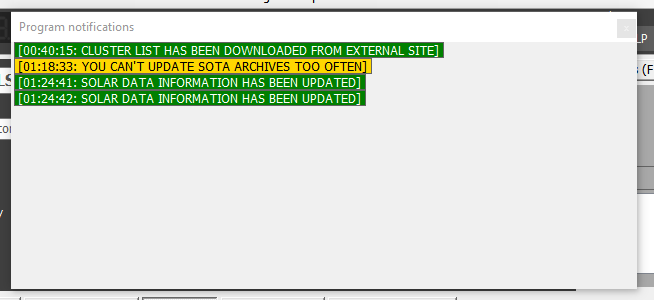

I get an exclamation mark and these are the messages behind them

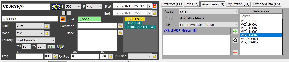

I've come back after some time - several hours, tried it again and now I finally get a green message as below
I must say that the yellow sign in the previous post does not clearly imply any failure of an update process. Perhaps it should be less equivocal and say, "update failed at this time".
Alan
And the VK2BYF/9 can now be assigned a SOTA referenceI must say that the yellow sign in the previous post does not clearly imply any failure of an update process. Perhaps it should be less equivocal and say, "update failed at this time".
