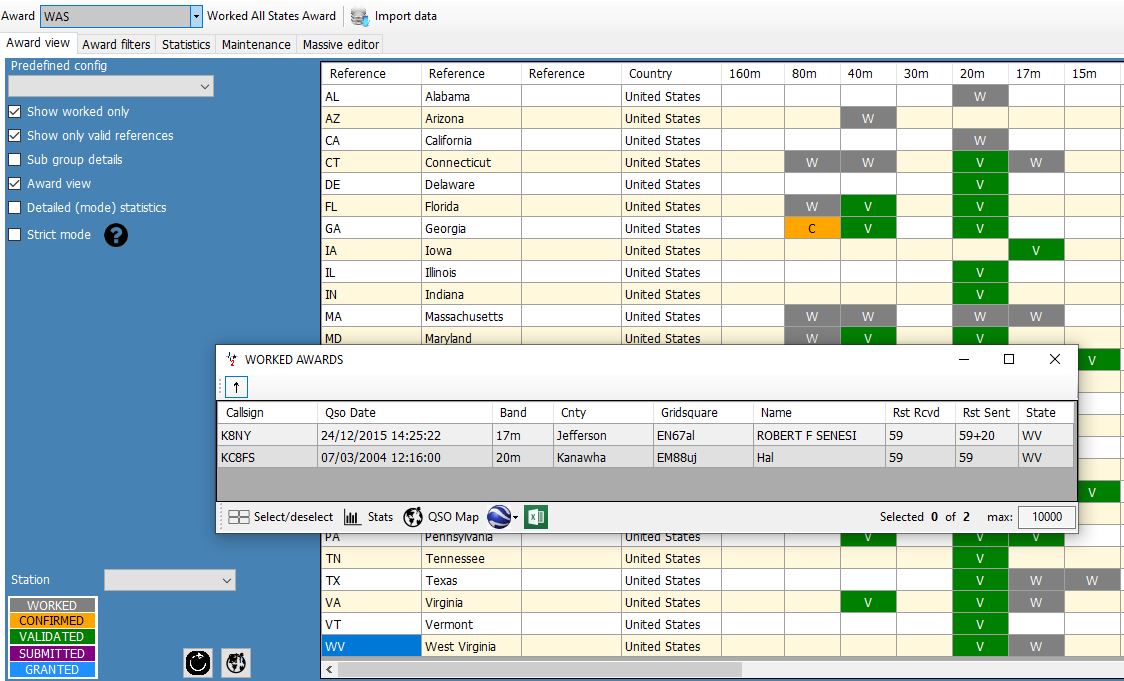

Also I am missing 23 FT8 West Virginia qso's, I had fixed this issue back in August after I started using Log4om but it seems to be an issue again. I'm not sure which Log4OM upgrade reverted back to missing WV qso's. I looked at the last ACLog file before I started using Log4OM and the WV qso's are there.

As for the bona fide WV states I just checked and its fine in my database, perhaps rebuild the references for WAS?

I changed the State in the QSO's that were showing VA instead of WV to WV. I didn't realize I also had to REMOVE the 'WAS@VA' in Award Refs too. So all looks OK now.
I remember changing the state to WV back in Aug 2020 when I first installed Log4OM, when I first saw the errors. I didn't remove the WAS@VA ref under Award Refs.
There were actually 2 State references; WAS@VA & WAS@WV in Award refs. So maybe when I installed the new 2.13 Log4OM version it took the first state reference WAS@VA that was left over from the first instance in 08/2020.
Anyway all looks good now.
