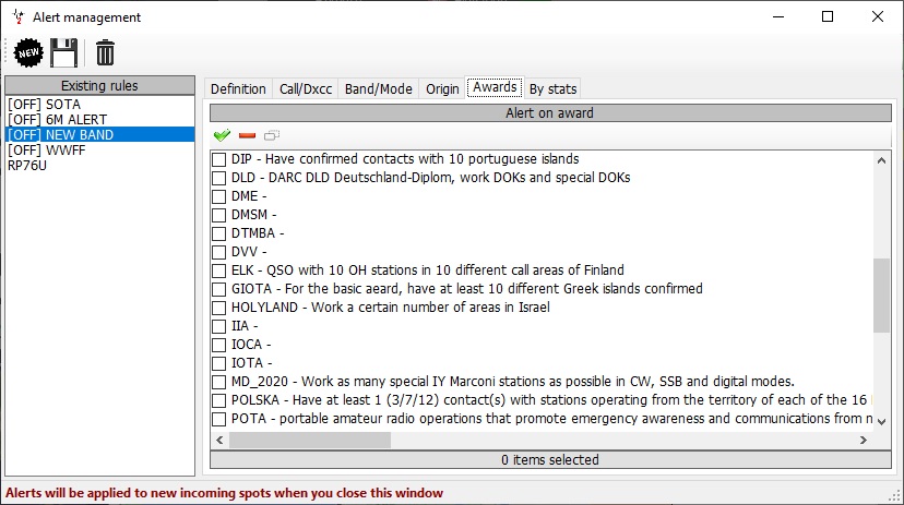

The cluster alert should work OK if you followed the instructions in our user guide age 74>>>>> and in particular the 'Awards' tab of that interface as below.
This should trigger a visual and audible alarm if a club member appears in the cluster.

Hi there, I am still not able to get an alert when a specific call which is part of a CLUB appears in the cluster.
- I have created an award names 91NET with a list of calls.
- In the alert management I have created a rule by clicking the name of the award in the "Awards" tab.
- I have activated the rule and saved.
When a station in the list appears in the cluster, nothing happens.
Any idea how to fix it?
