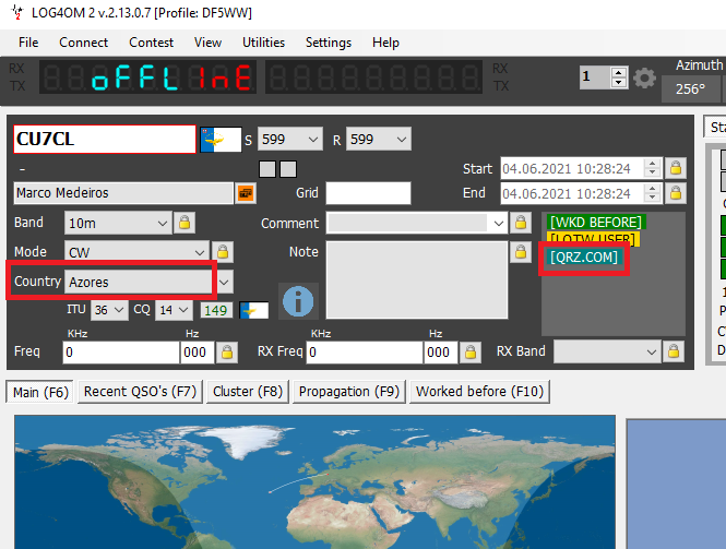

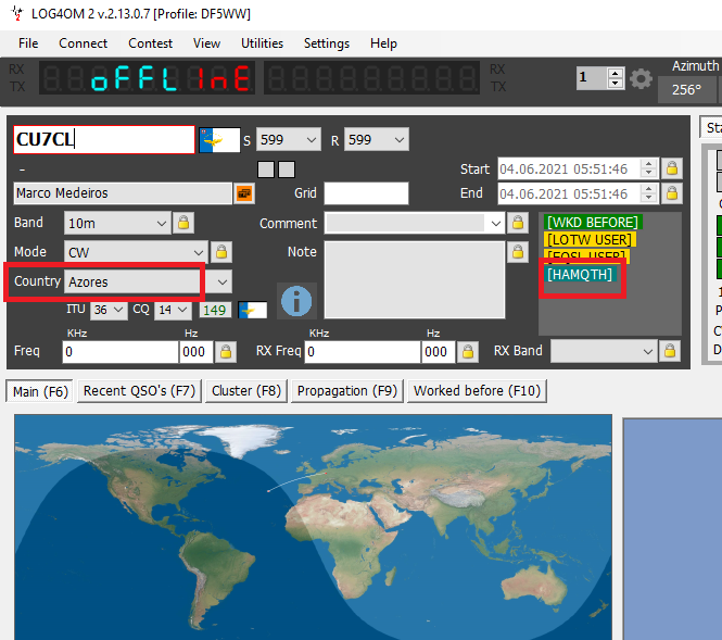

Don´t know where a Problem is but on my side it show´s Azores. I´m using HamQTH for
the online lookup.
the online lookup.

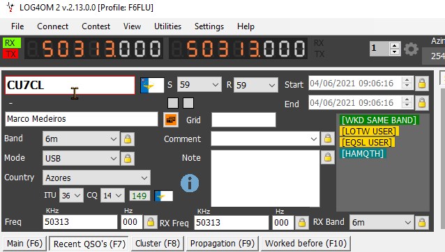

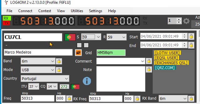

Thank you very much Juergen, it's very interesting ...
So I put HAMQTH in "primary source" in "Settings / Program configuration / Info provider" and QRZ.com in Falsafe and indeed in this case I have "Azores" as country
Does this mean that there is a Pb with QRZ.com?
However, I can see that the ClubLog file is updated regularly.
Can you give it a try by putting QRZ.com in "primary source" to see if you have the same problem?
If you have the same problem it means that there is a problem with QRZ.com, if you do not notice this same problem it means that there is a problem with me but what problem?
Do you have any advice for me?
In any case, thank you for taking the time to do this test. Thanks and 73

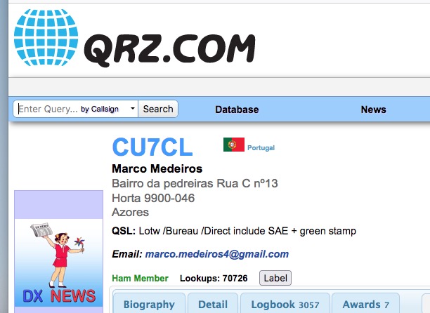

If you check the callsign on QRZ.COM it resolves Portugal, as the user set PORTUGAL on his QRZ.COM
That's not a Log4OM issue or something we can fix. The callsign owner, for some reason, set his country to Portugal in QRZ.COM, while according to the callsign it should be Azores.

Still wondering. For a test i have set qrz.com as primary source and i receive Azores from QRZ.com too.
Only difference is that i don´t receive a Grid but i´m not a xml subscriber and that´s normal.

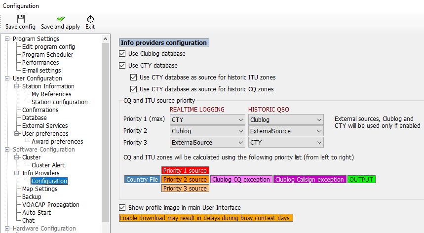

And that´s my settings in the configuration Tab ....

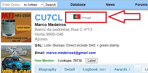

No the country shown on QRZ is Portugal and that is what is received from QRZ by Log4OM from the lookup so it remains a QRZ issueF6FLU wrote: 04 Jun 2021, 09:43 OK Daniele;
thank you for the explanations but on QRZ.com it is well put like Azores ...

Hi Daniel,
I'm a QRZ.com subscriber and I have the same problem. As Terry mentioned, this is a problem with QRZ.com. Marco CU7CL needs to correct this under "Update the basic callsign data" and, under Country, select Azores instead of Portugal.
