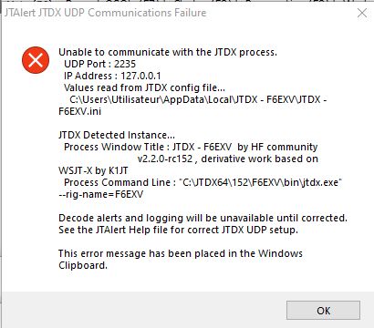

JT alert does not receive the callsigns (the header shows ??? for the band), and after a while, I get an error message as shown in the attachment.

I followed the instructions step by step, and... it does not work...
