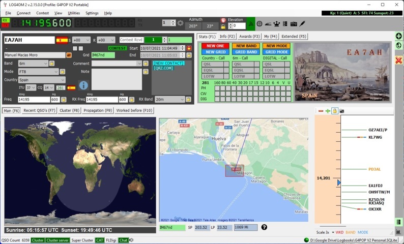

Have you set the contest dates correctly in the Contest settings, I have just tested and it works fine as below in main UI and Winkeyer
Untitled (FILEminimizer).jpg (128.58 KiB) Viewed 3413 times
Untitled2 (FILEminimizer).jpg (112.68 KiB) Viewed 3411 times

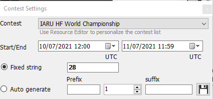

Screenshot 2021-07-10 131257.png (11.51 KiB) Viewed 3411 times
i think that's correct.

Re: N1MM interaction
HB9ETR wrote: 10 Jul 2021, 11:13 Screenshot 2021-07-10 131257.png
Then when I press the crown....nothing
Rob,
Terry noted above to check the start and end dates in your contest setup.
The screen clip you posted indicates the contest won't be starting until October 27, 2021.
Open up dates say from first of this year to end of this year and give that a try.
You posted this screen shot before the start time of the contest today so of course it wont start the contest window, try changing the start time to 00.30 hrs

Rob,
Nolan,
Date format shown is European Day/Month/ Year like 10th July (07)

Terry,
Seems on my system a right click on the crown is not good enough.....needs to be a right click/hold to turn it all green.
All working now.
tnx for fb
