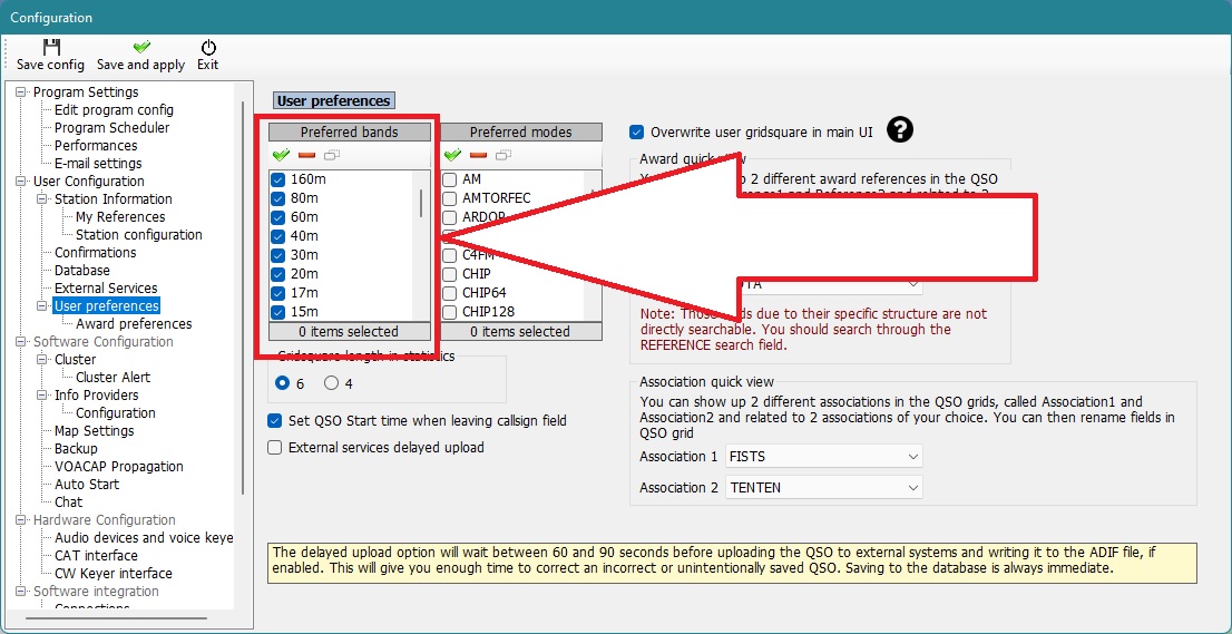

You can modify the file yourself its called bandplan_dxcc291.xml and its located here C:\Users\YOUR USER NAME\AppData\Roaming\Log4OM2\bandplan
Did you ensure the bands are selected correctly in the settings/program configuration/user preferences menu
