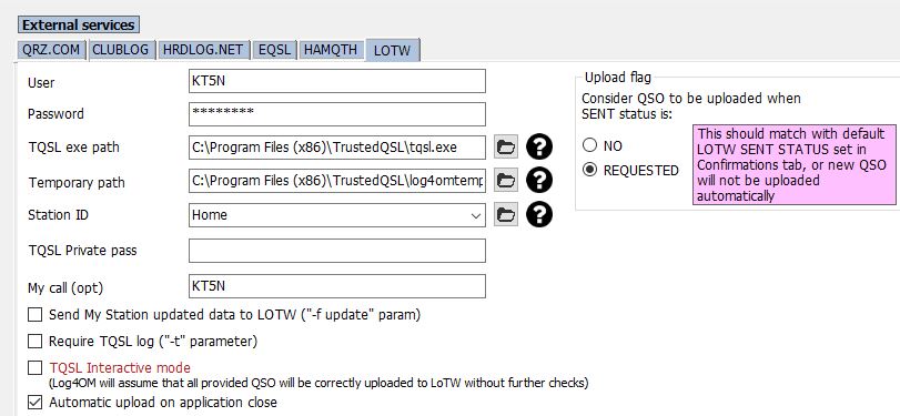

Hi Terry, sorry to bring this up again. I have read the other posts about it and tried the solutions suggested to no avail. I am using the latest tQSL version (2.5.8). The information in the configuration looks correct to me as far as directory paths etc. Both the configuration settings and external settings are set to "requested". I can manually download LOTW confirmations just fine, but have resorted to uploading from QRZ.com. The attempted Log4OM LOTW uploads just 'hang'. The LOTW website shows my uploads from QRZ.com but not the attempted manual Log4OM uploads or the automatic uploads upon shutdown.
Here are some hopefully helpful screenshots:

- Capture1.JPG (59.87 KiB) Viewed 1632 times
- Capture2.JPG (40.33 KiB) Viewed 1632 times

Jeff,
I'm sure you have tried a 'manual' upload from the QSL Manager / LOTW? In that did you use the 'Select Required' button to choose the QSOs you need to upload to LOTW?
As a very simple test if you have only one QSL for uploading to LOTW you can simply left click on it (thus it is selected) and then tap the Upload Selected QSO. Then the upload operation begins.
This also assumes that you have all items set to ID the QSO for uploading with either a NO or REQUESTED in the 'Sent' Column.
Anyway ... I've listed below the URLs for the 3 YouTube videos that Terry created related to Confirmations that take you through the steps for uploading. I've posted a similar reply recently in another LOTW thread that you may have run across. That being the case ... take the time to watch those videos very carefully. There is some little tweak that needs to be adjusted and should then resolve your hiccup.
