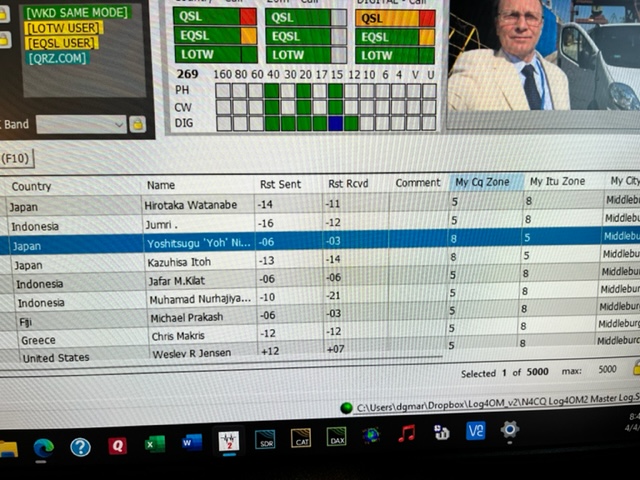

Attached is a photo of the reversed zones. I "corrected" the first two log entries by editing to set zones correctly. The second two entries are reversed. The US is in ITU Zone 8, Florida is in Zone 5. The config setting in Log4Om is correct. Dave

Dave,
Noting your log it appears you are running JTxx and getting input from WSJTx, JTDX, JTAlert or Gridtracker.
Those zone values are likely coming from those APPs. When that data is inbound to L4OM via the UDP connections it is not modified from those sources.
Double-check any/all settings in those APPs.

Thanks to Bill, W2PKY. He pointed me to his error in JTA which was the same error I made when I reloaded the software after WIN 11 upgrade. I had reversed the Zones in JTA - rookie mistake (or a truly Old Man mistake). Fixed now, thanks for the feedback. 73
