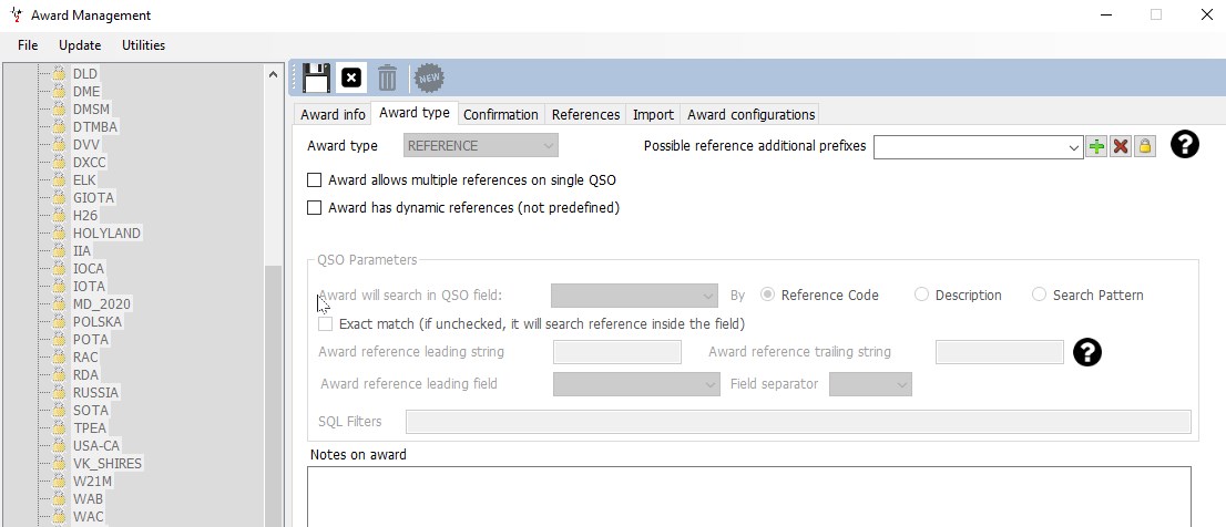

another question, when and how can we modify this part in the Award Management window
For example I would like to modify the RAC award
I would like Lo4OM to calculate the RAC also if in the STATE field there is the RAC code.
For that I think I would have to tell him by selecting "Award will search in QSO field and selecting the" STATE field but we don't have access to it
Can we modify this award and if so how?

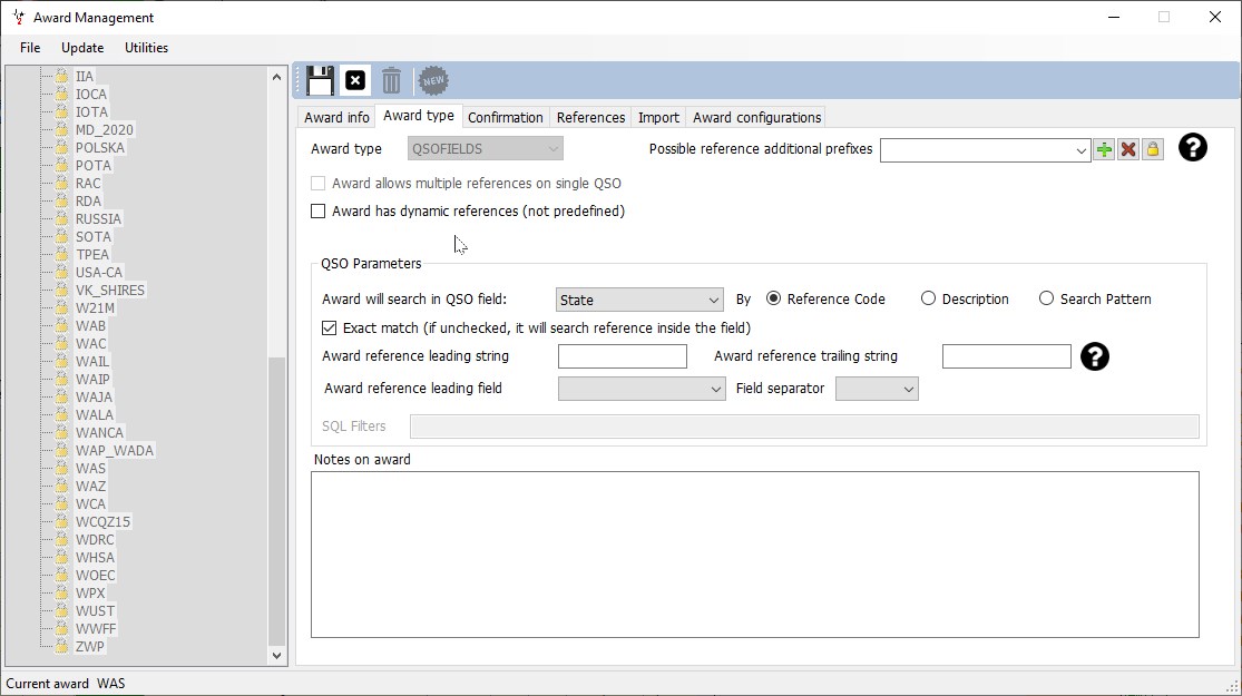

Example about WAS :
in this example (WAS) we can see that the type of award is QSOFIELDS and in this case we can select "Award will search in QSO field and selecting the" STATE field
but in the case of RAC we cannot tell him that the type of award is QSOFIELDS and not REFERENCE
I think it's done on purpose?
Can you detail this operation?
and tell us what can be changed or what MUST NOT be changed.

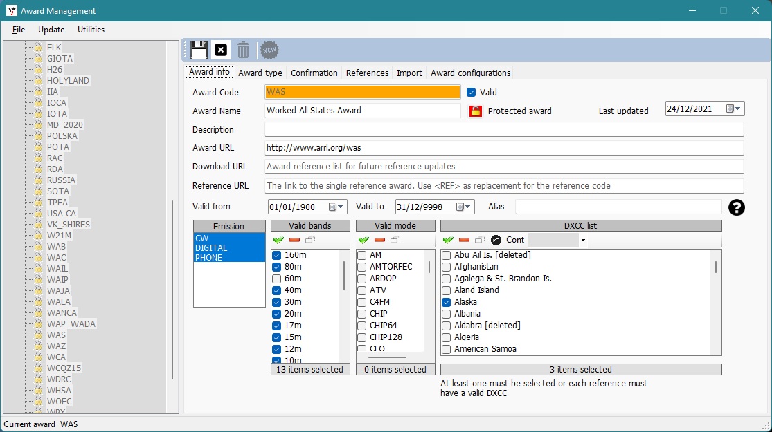

Double click award in left column to open for editing

Double clicking the award name in the left hand column fills the right hand tabs with editable data, I just tried this and it worked fine, see below:

I talk about the award type not award info ..

That single field cannot be edited because it is the base style of award selected at conception, if you want to use another award Type you must generate a new award and select the type at the start of constructing the award

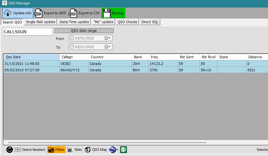

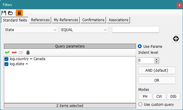

I would use QSO manager and filter as below
Then Update Info on the selected as below
