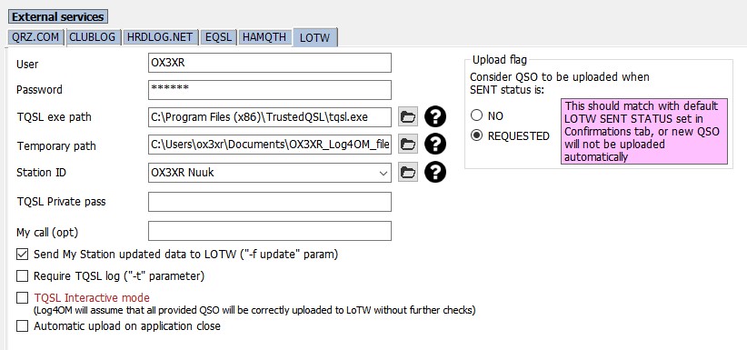

After upgrading to Log4OMV2 to ver. 2.18.0.0 uploading to LoTW no longer works. I get the error message 'ADIF file not found on path' se attached screenshot. The 'Temp LoTW path' is working and has been used several years. The file named 'LOTW_UPLOAD_20220101213011.adi' cannot be found on my PC.
The Log4OMV2 config (see screenshot) from the earlier Log4OMV2 version is used in this new ver. 2.18.0.0.

TQSL.exe has been updated. TQSL path in config is consistent with the path in the Log4OMV2 config.

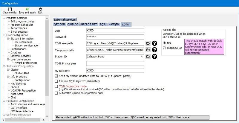

I've attached a screen clip of my LOTW Config settings. Before doing a reinstallation double check your choices for the Confirmations choices for LOTW. I happen to keep both my LOTW Sent & Rcvd set to "no". According to your LOTW Config screen clip you are looking for "Requested".
Maybe on a manual upload the value on your saved QSOs is not matching either a "no" or a "requested". If there is a mismatch there won't be an adi file created as it can't find a match for the QSO to then be saved for the upload.
Page 97 of the current User Guide goes over the "confirmations" settings and Page 106-107 goes into the Manual LOTW Upload steps. Make sure items in the box on Page 106 are noted to ensure they match.
