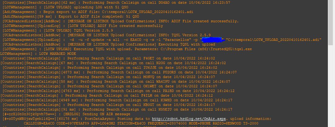

Thanks Terry for your quick response. I have put all the LoTW configuration parameters back but the problem persists. I attach an image where you can see when the QSO loading process stops

I've checked the log and apparently I don't see any errors. The process stops when it opens tqsl.exe and I have to close it from the task manager and if I want to close LOG4OM
