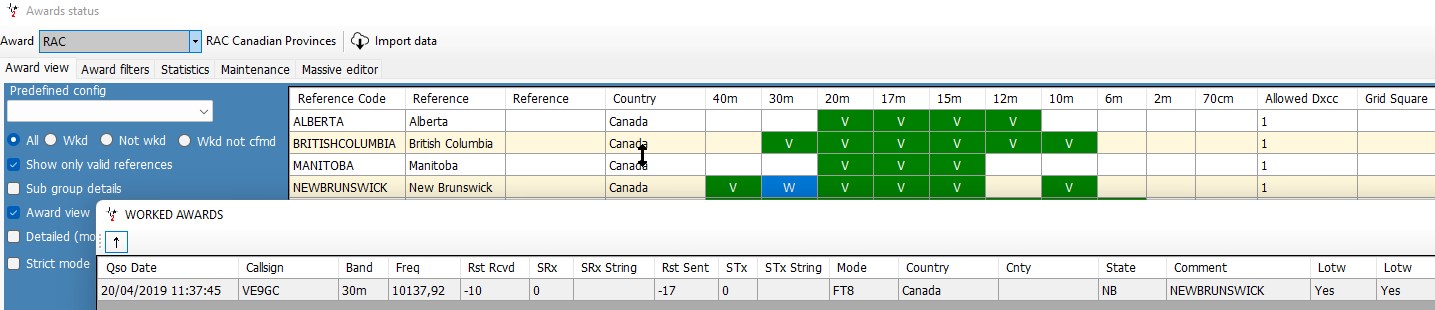

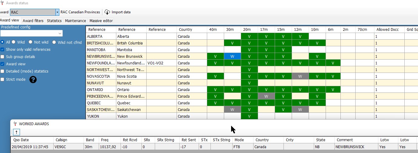

I have a QSO validated by LOTW with VE9GC (NEWBRUNSWICK) even by recalculating the Stats I still have this QSO in W not in V
I put "NEWBRUNSWICK" in the comment field, I assumed that this allowed L4OM to validate this QSO.

I try to add "New Brunswick" in the comment Field but not works ...

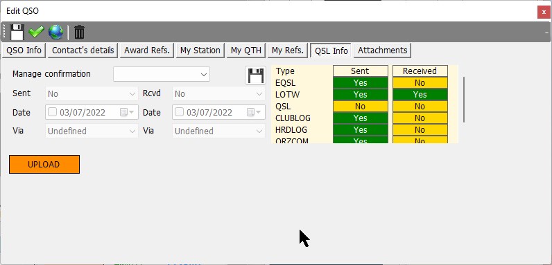

Have you checked the LOTW status in the edit window of that qso?
It's the confirmation status that changes the W to V nothing to do with the province name

I redid the manipulations Upload to LOTW then Download;
the 2 flags LOTWS and LOTWR are set to YES

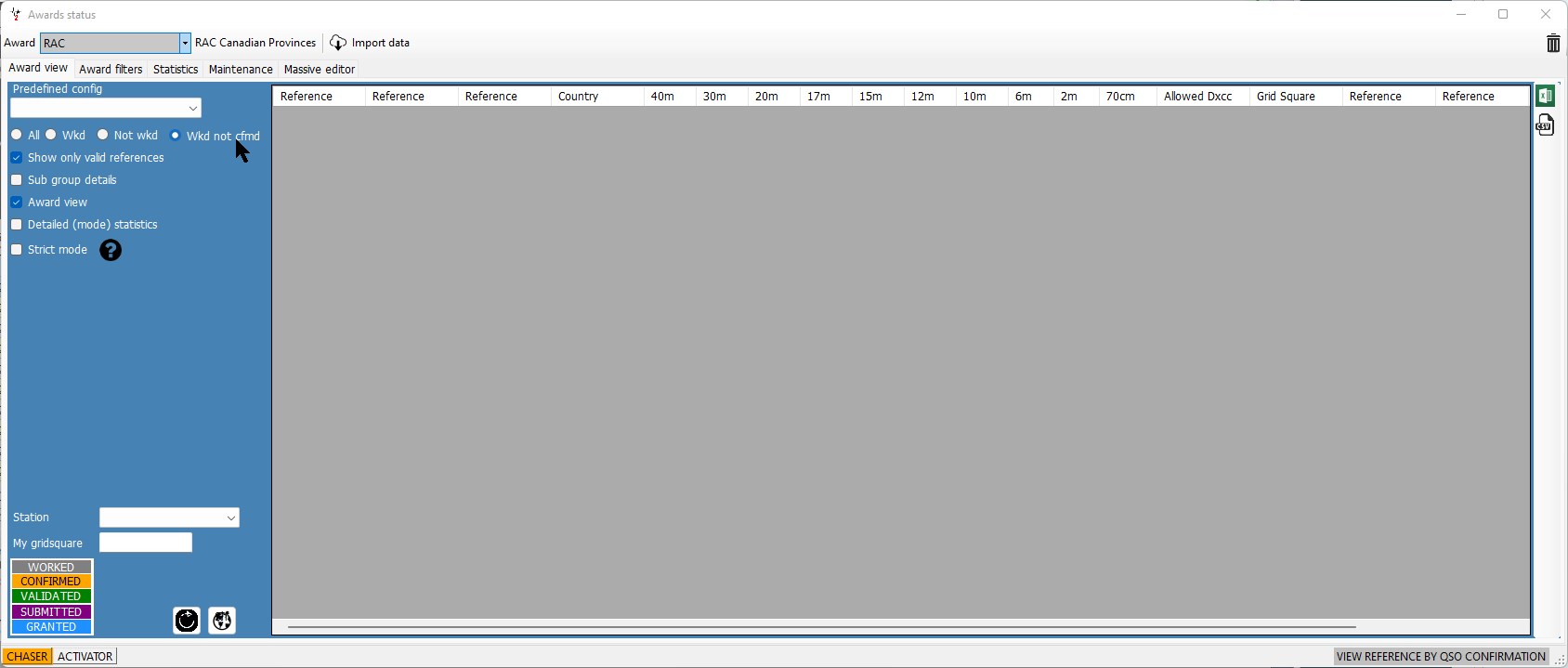

What is strange is that if I look at "Award RAC / All" I always see my QSO with W
but if I look at "Award/Wkd not cfm" I don't see any unconfirmed Canadian provinces
so my QSO must be well considered as confirmed but I don't appear as confirmed ??

I actually meant you to re save the LOTW received status in the QSO edit screen thats why I refered to LOTW confirmation status
Re: Award problem (RAC)
I did the trick but it didn't change anything.
But I'm not sure I'm doing exactly what you want...

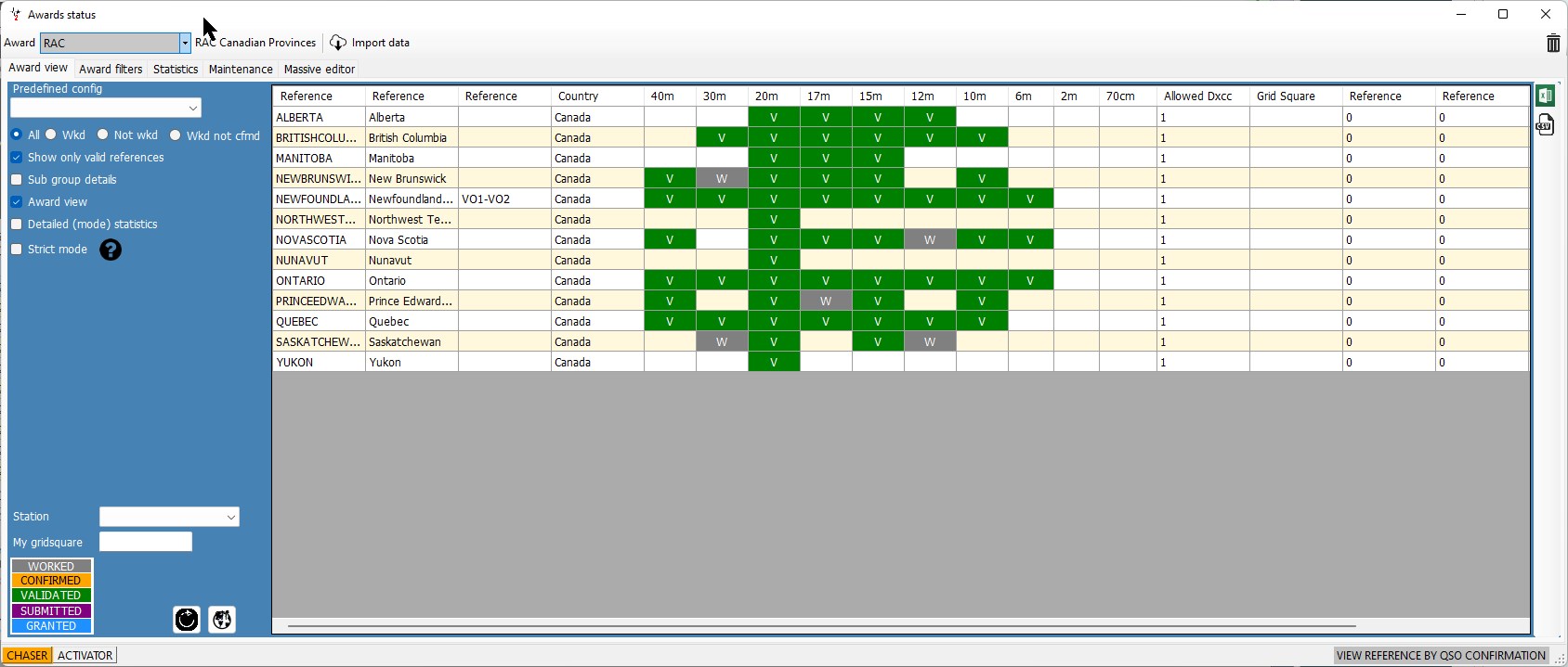

I have the same problem with other QSOs for example VA5DX (Saskatchewan) is in W on 30M because I did not receive the LOTW confirmation
I modify the QSL LOTW by editing the QSO and therefore by putting LOTWR = YES, I recalculate the statistics and the QSO remains in W and not in V in the Award RAC window
