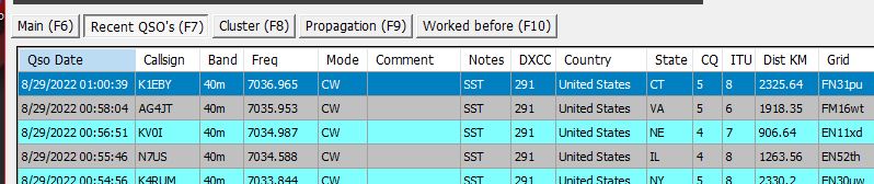

Just curious ... what does your Recent QSO (F7) grid show for date? How about the grid display in the QSO Manager window?
Also (just thinking outside of the box here) what are your time/date settings in your computer?
Image below is a clip from my Recent QSO (F7) grid.
I just did some testing with my Windows O/S settings and depending upon various settings the date format with the hyphen will appear.
Log4OM uses the date/time format that you have selected for your Windows O/S. This may be the source of the issue you have noted.
