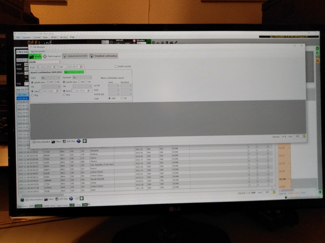

Log4OM version number please and a screen shot of the QSL manager window having entered the call sign and clicking your return key on keyboard
Re: Recording paper QSLs in QSL Manager
Log4OM version is 2.23.0.0
Attached file as per your request.
I've also watch your video on Youtube re. recording paper QSL and when I try to do the same I don't get the same response on my screen. As an example, when you're putting in different call signs in the CALLSIGN field, you get an immediate response in the window below showing the call signs you're looking for. When I do the same nothing happens. Thanks

1. Having entered the call sign do you press the enter/return key on your keyboard?
2. Have you tried a clean install of Log4OM

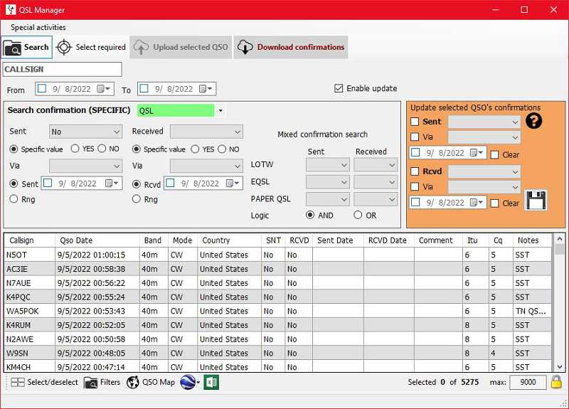

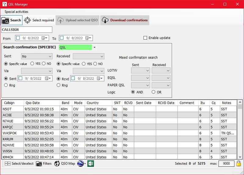

- On the Main UI when you select the Recent QSO's (F7) tab do your Q's appear?
- If you see your Q's with the above step ... with the QSL Manager open and QSL is selected. Do you get a list of your Q's when you tap the green Search button? Do NOT put any callsign in the 'callsign' field for this listing of all your Q's.
- I entered a call (n7us) and tapped search for my list of Q's with him just as an example of my results.
- qslmngr-qsl-search-update-medium.JPG (69.07 KiB) Viewed 1445 times
- qslmngr-qsl-search-n7us-medium.JPG (75.64 KiB) Viewed 1445 times
- qslmngr-qsl-search-medium.JPG (70.29 KiB) Viewed 1445 times
