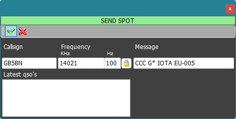

Do you see this dialog?

Hi Terry ,
No that does not show up like it use to. any suggestions ? should I reinstall program ?

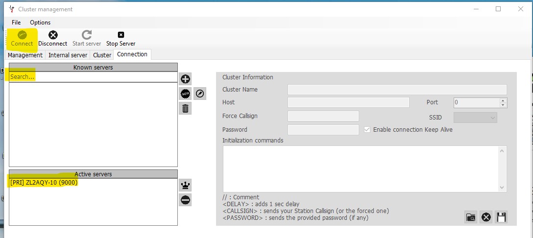

Post by ZL3TRR »
Hi Terry ,
Still having this problem. I do note that in cluster management it says im connected which is greyed out and I have one pri active server but I dont see anything in Known servers. See attachment.

Posts: 11605
Re: SEND SPOTS

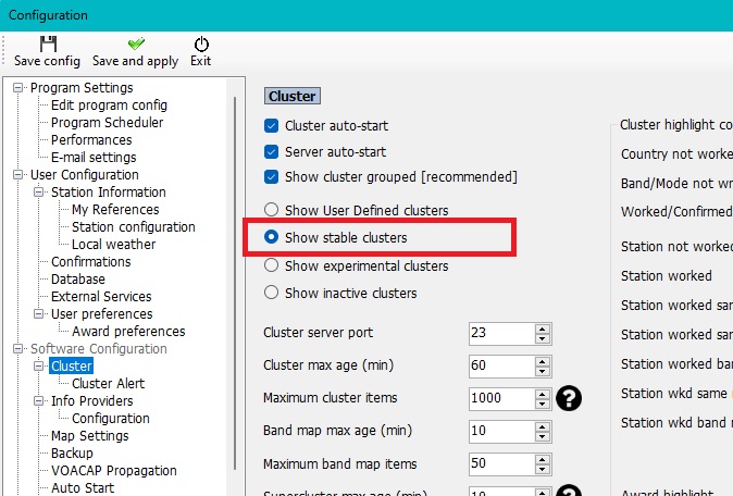

ZL3TRR wrote: 22 Dec 2022, 03:32 I do note that in cluster management it says I am connected which is greyed out and I have one pri active server but I dont see anything in Known servers. See attachment.
Make sure this box is checked in config and restart Log4OM then you should have a full list. Try another cluster ansd see if you can send spots

ZL3TRR
Posts: 7
Joined: 03 Aug 2020, 20:57
Re: SEND SPOTS
Post by ZL3TRR »
Hi Terry ,
Thanks for the quick reply.
Clicking on the show stable cluster box fixed the known servers search . Thank You
