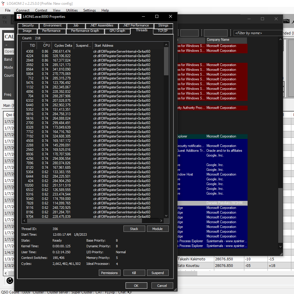

Overnight with nothing being logged at all Log4OM on the brand new VM began to consume 100% CPU. It seems to be creating lots of threads for clr.dll!DLLRegisterServerInternal+0x4ad60. Normally while idle it uses 18 threads but when I found the CPU in the VM at 100% this morning it had 218 threads.

Thanks for details, i will investigate this behaviour.
About voacap: every hour log4om recalculates the whole voacap data set (all bands on every 4digit gridsquare in the world, pretty intensive activity).
those data are used to extimate propagation info on cluster realtime view and draw the propagation maps (it doesn't affect the realtime calculation made on every callsign typed)
This could effectively drain a lot of resources.
Thread proliferation is, indeed, not normal and worth a check
