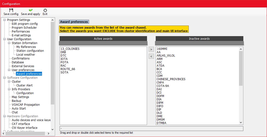

I'm not sure if I'm fully understanding your question, but you can choose which Awards you want to actively follow in your configuration setup.
Screen clip below is my current setting.
- AwardPrefs.JPG (84.64 KiB) Viewed 1714 times

Thanks for your reply. I have all of the awards as active right now. For example I check "POLSKA" and nothing shows as worked when I know I have worked at least one and same for RAC, RDA, Chinese Provinces as just an example. What must I do without as I have heard "play with excel and import" I would like to just click on an award such as DXCC have have the computer tell me what I have worked.

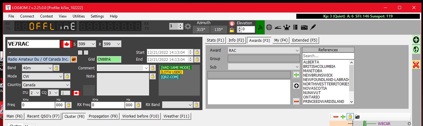

You won't see the 13 Colonies or Route 66 Awards in the basic Log4OM Award distribution package. I built those awards myself for my own use. Easy enough to do and explained in our User Guide.
As for the award assignment to any given callsign you have to select the award and the related reference to that callsign.
The Awards search mechanism looks at the data in the 'notes' field as that is where such is typically noted, however OMs seldom put the data there.
As I'm making Q's with a given callsign I will select the Award and choose the reference and save at that time.
The one shown in the clip below is for the VE7RAC call I contacted recently. All the *RAC calls default on lookup to Ontario (as best I recall), but will be operating in a specific province so I picked up that more precise information as I made the Q with VE7RAC. VE7RAC was Ontario, but VO2RAC was in Newfoundland / Labrador.
Same goes for IOTA and POTA. You have to select the Award and the Reference and add to and save with the Q.
- awardchoice.JPG (102.11 KiB) Viewed 1708 times
