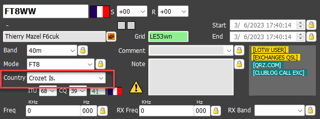

LOG4OM report FT8WW as France and every time I need to change it manually to Crozet Is.
How to update this in the country file?
Sorry for posting it in FT8 & MSHV Discussion.
Thank you
VU2MB
Re: LOG4OM/MSHV & FT8WW
Log4OM is reporting FT8WW as Crozet for me.
Maybe update your resources under settings.
