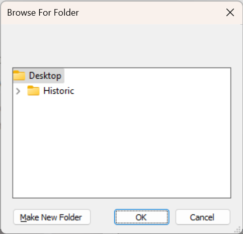

Re: Win11 Backup Folder selection seems broken
This problem has not gone away and now I have zipped backups scattered in the icons on my desktop. Below is a screenshot of what I'm presented when I attempt to navigate to a suitable backup folder. The only choice I'm given is something under "Desktop" which is not a good choice. Regardless of how I try to enter my external drive or one of the alternate drives on my system, it only allows the Desktop as the choice (or whatever folder I created under it.) What am I missing?

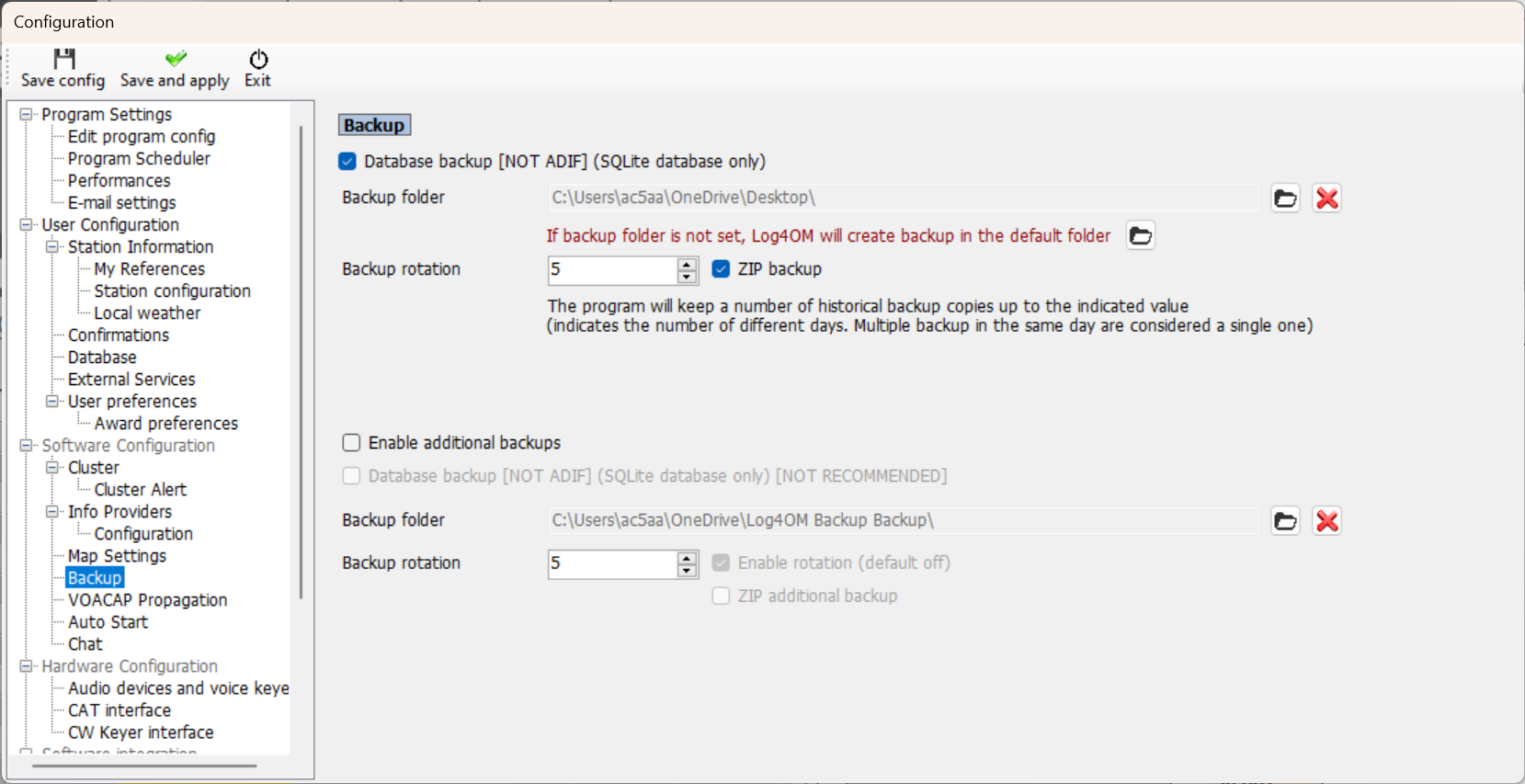

What happens if you click on the folder icon to the left of the red Cross alongside the file path
I receive the window below - which only allows me to create folders under the "Desktop" (i.e., on the Desktop). I get the same result below if I turn off the main backup function and enable "additional backups."
