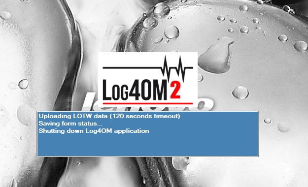

Hello All,
I am a recent user with L4OM and am very happy with its utility. It worked great and I ran a pile up of 40 QSO in one hour during the SC QSO Party. Worked Great!!
I upgraded afterwards to the newest version and have recently had issues when I exit L4OM. The splash screen comes up with some dialog but it will not close. I have tried to let L4OM close itself for over an hour on several occasions but no joy.
I installed the latest TQSL but that did not help. Is there a setting I can look at or should I try an uninstall / reinstall?

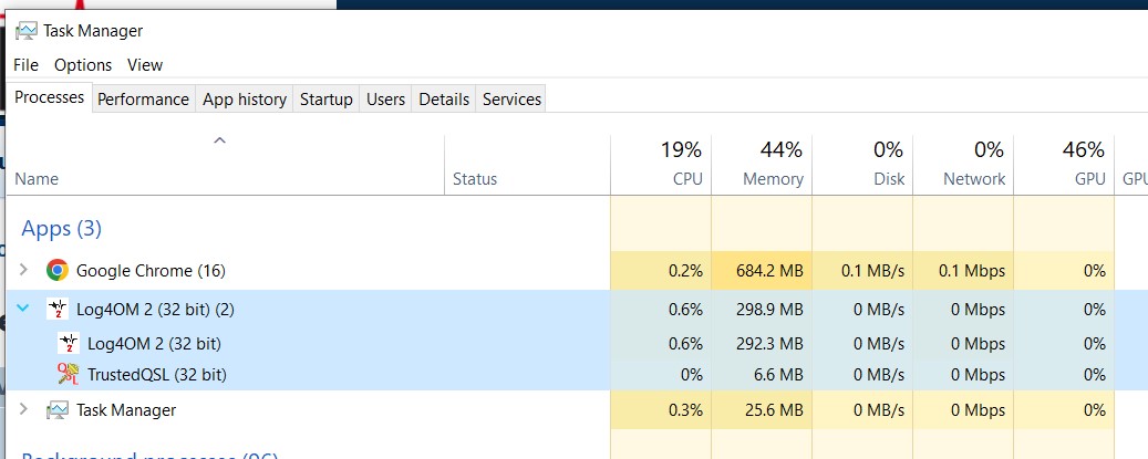

Pictures show the hung splash screen and Task Manager (notice that TQSL is running)
Thanks for the help and 73,
Phillip

Re: Log4OM not shutting down, Splash Screen stay up forever
Try turning off upload on program close in External services/LOTW of the Program configuration.

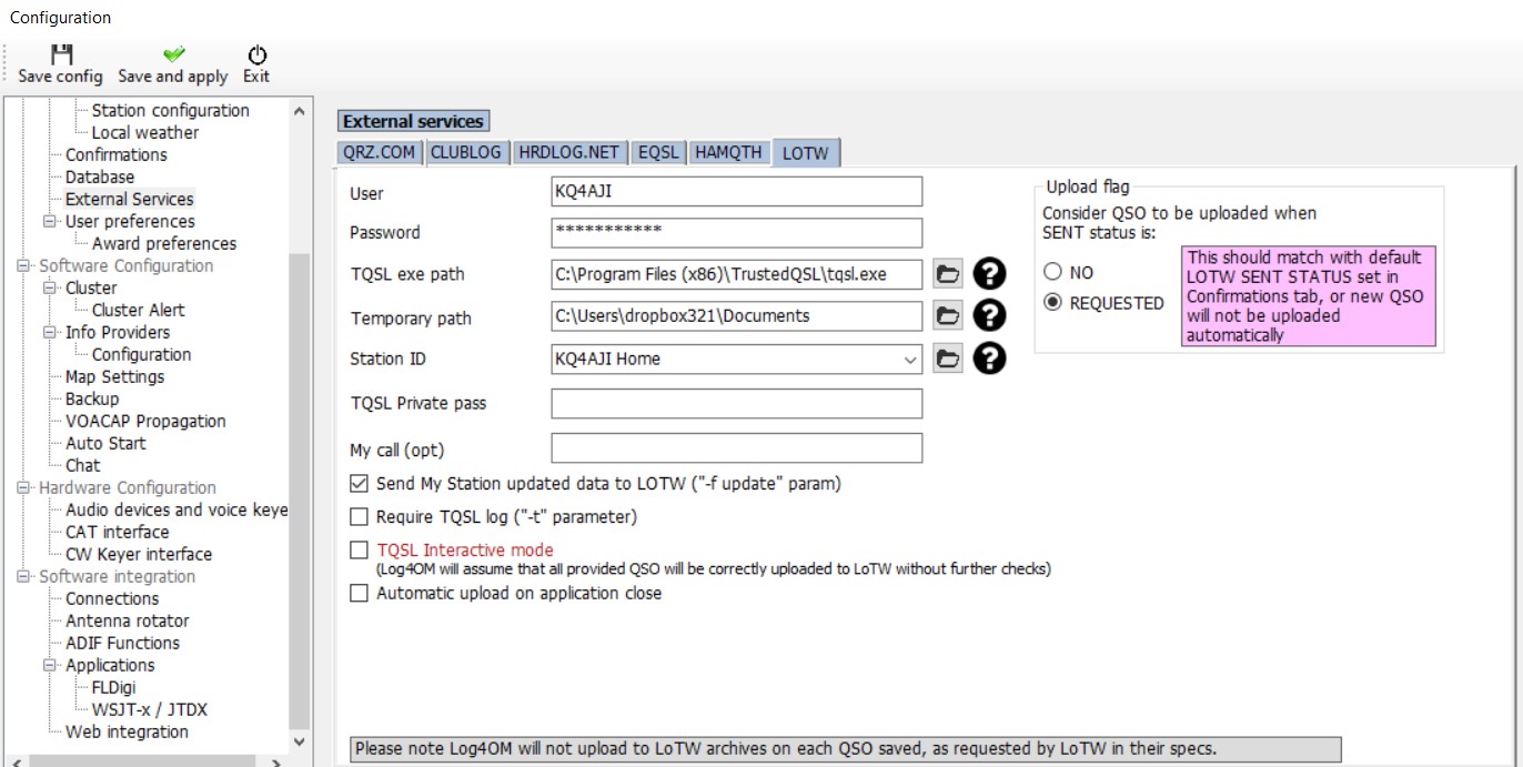

I don't see "set TQSL to run as a standalone" option on the config>>external services>>LOTW tab. Am I in the right area?

Posts: 11605
Enable TQSL Interactive mode

Post by kq4aji »
Worked like a champ. I re-enabled the "upload on program close" in External services/LOTW and it is behaving perfectly. Thanks again.
