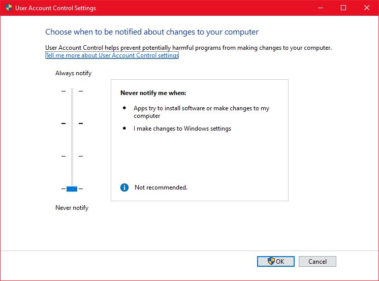

UAC = User Account Control settings
This is part of the Windows O/S. Sometimes having this control level set too high can cause limitations.
Click into Windows Settings and key in search for UAC and you should have a hot link to take you to the "User Account Control Settings"
At least it is an item to check.
Screen clip below is from my current settings.

Nolan,
OK, I know what that is. I set it to the lowest setting, no change on the SPOT window in Log4OM
