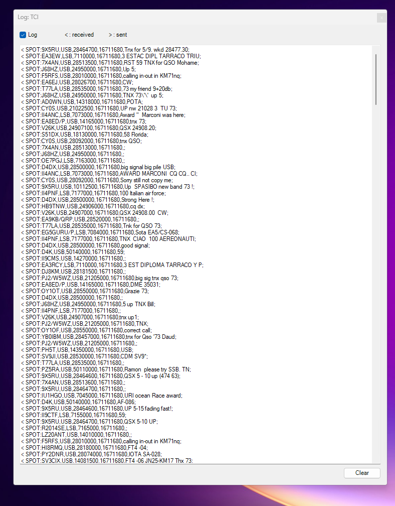

I use Log4om v 2.27.1.0 with my ANAN-rig with Thetis software using TCI as CAT-protocol.
When sports are sent from Log4om cluster to Thetis panorama using TCI, CW sports are always coded as USB. Clicking on a CW spot on Thetis Panorama changes mode to USB. Clicking on the same spot on Log4om Cluster or Bandmap, puts the Transceiver in CW mode.
Looking at the TCI Traffic log in Thetis shows that all CW sports received from Log4om are coded as USB.
See enclosed screenshot.
I guess this is a bug in Log4om.
73 de LB2EG Richard

Fixed in beta 2.27.1.2 today.
