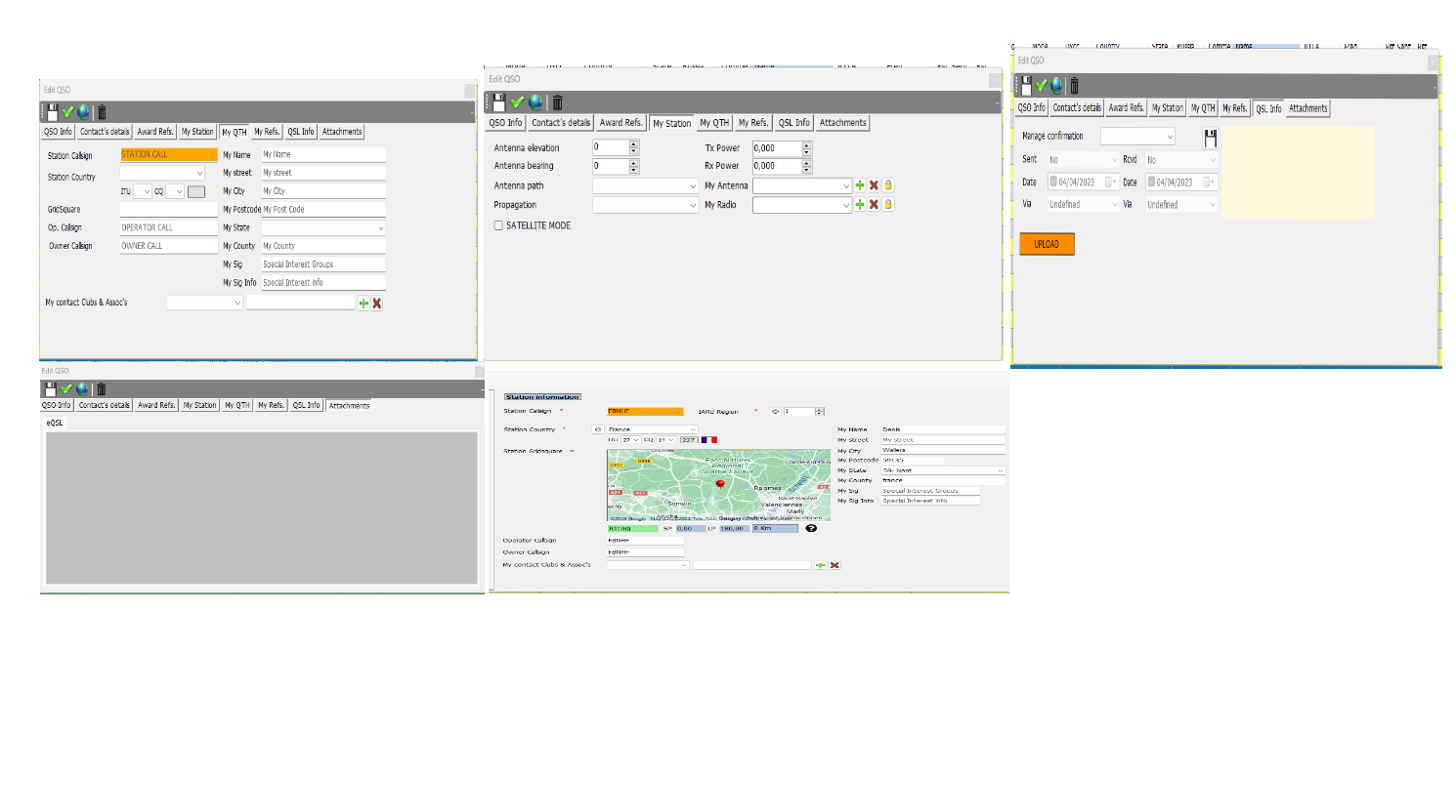

I have just started with LOG4OM and I have some configuration difficulties
the tabs edit QSO/My station / My QTH / QSL info / Attachments are not filled in, see screenshots
I have also attached the User configuration / Station Information window
Thank you for your help
73 Denis F8NHF

So this is when you double click a QSO you have made under "Recent QSO's (F7)" ?
Re: QSO edit window
Hello Rich
It was me who worked with Denis F8NHF
Yes this happens when you double-click on the QSO (F7) I don't know why everything is fine with me and we have the same settings

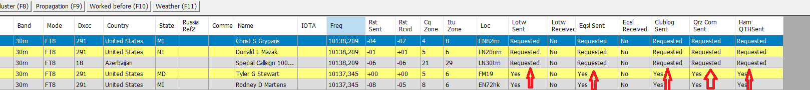

Hello RICH
here I followed the help page 216 deletion and creation
the problem remains the same no upload to QSL services when closing the log everything is loaded
copy of the log

Re: QSO edit window
Use No instead of requested and try again

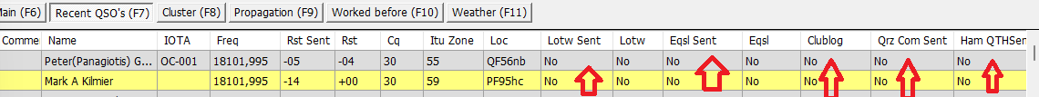

Re: QSO edit window
Hello Terry
I have just passed the QSO in NO it is still not sent when closing the log everything is loaded
my configuration is the same as on the videos
copy of the log
