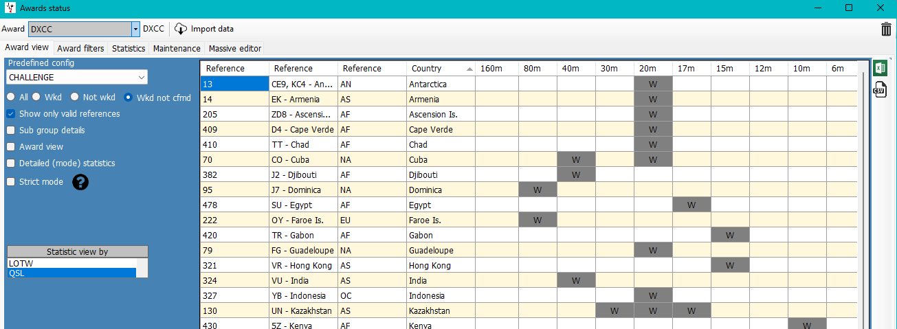

Re: List or report of QSOs with DXCC Challenge entities only QSLed by paper QSLs?
With your advice, I got the above.
I am interested in the confirmed band entities only confirmed by a paper QSL, not by LoTW or both LoTW and a paper QSL. Can I modify this report to show this?
The two band entities in orange for VU4 are confirmed only via LoTW. That is fine for me since I can use the two LoTW confirmations to get them validated by the DXCC desk for DXCC Challenge; I do not want them to be listed.
I want only those confirmed band entities confirmed by a paper QSL only to be listed because I need to send the QSLs with those contacts to a card checker to validate them for DXCC Challenge.

If he selects 'Wkd not cmfd'. the list will contain only QSO's for stations worked but not confirmed by any method as in my image below.
He can then choose either to export this data as an Excel or CSV file by clicking the buttons on the right hand edge of the window - I beleive ADIFmaster will convert either to an ADIF file or use one of the on line converters.

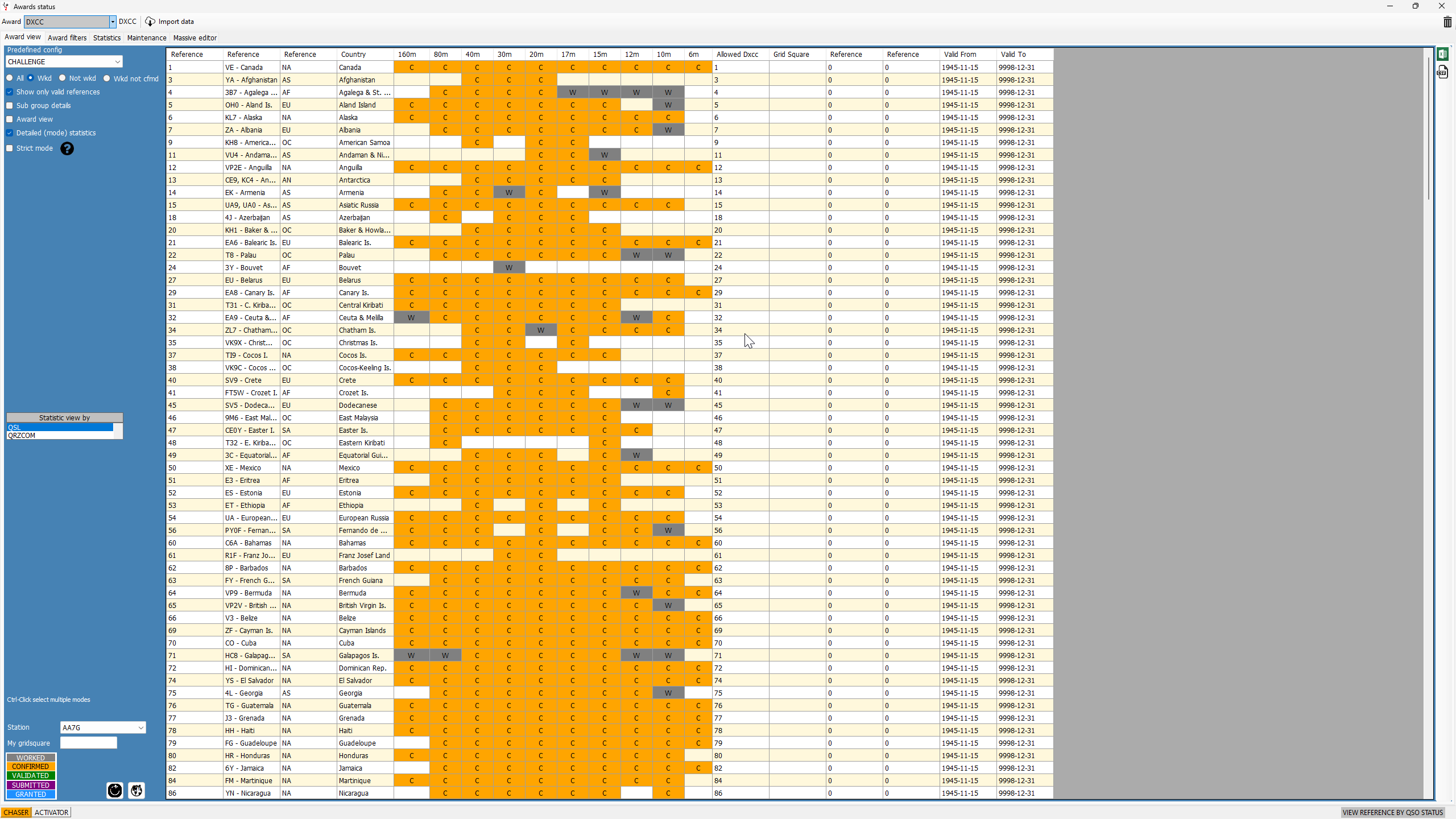

What Gert (and anyone preparing for a DXCC card check) needs is a report or adif export which contains only QSL cards confirmed, but NOT otherwise confirmed by LotW, and of course, needed for Challenge points.
Here is an example - only the yellow C blocks are desired in the report - circled.
Thanks,
Doug
