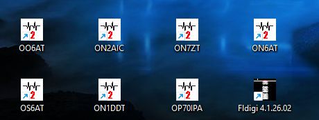

The 2 calls are ON6AT and OP70IPA
See: OP70IPA_ON6AT_icon.jpg

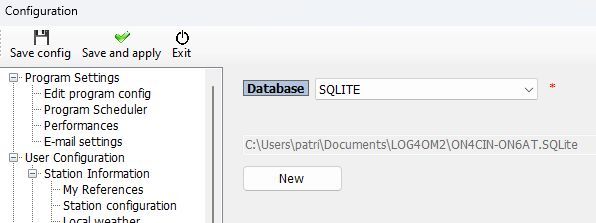

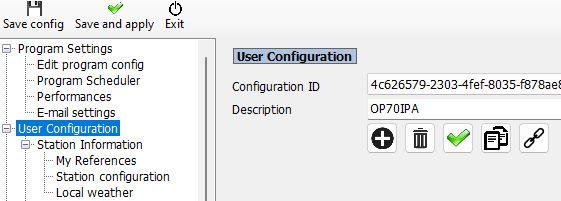

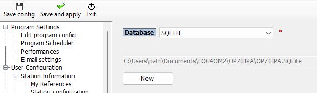

Via setting, configuration, User Configuration I created an ID with OP70IPA and via Database I have a SQLITE as OP70IPA.SQLite.
This file is located under the folder LOG4OM2 as provided.
The other setting in LOG4OMV2 for OP70IPA is, see photo

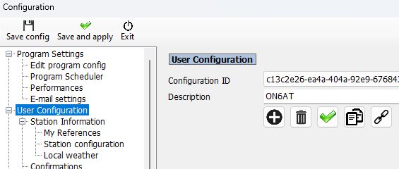

The regular callsign ON6AT also has a separate ID and Database ON4CIN-ON6AT.SQLite See picture.

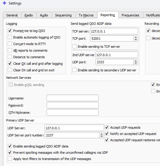

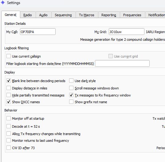

Now I use JTDX for FT8/4 modes.
My settings are there, see

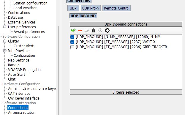

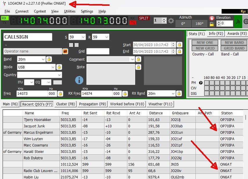

I noticed that the QSO's made with OP70IPA are also forwarded to my ON6AT database.
How is that possible?
However, they are separate databases with separate ID numbers.
In JTDX and WSJT-x you also have an ADI file and a log file, but they do not send data to LOG4OMV2 through the 2237 UDP port or am I wrong?
