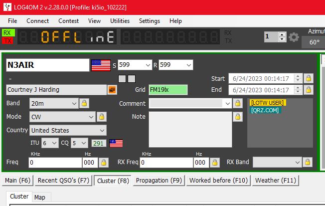

When doing callsign lookup the Grid square it displays is incorrect. This is happening on 2.28.0, I know this was a bug before, but believe it was fixed.

I've done several callsign lookups for gridsquare anomalies and I'm not seeing any. Unless FM19lx is not your gridsquare else it is wrong in QRZ as well.
I have no other APPs running. Just Log4OM and I manually entered in the callsign including yours.

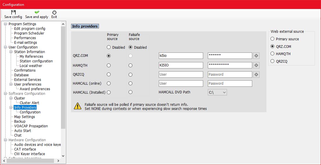

What is your Primary Source for Info Providers? QRZ, HamQTH, QRZCQ, HamCall

QRZ.COM, I will take some screenshots showing the issue looking up various calls signs and the grid result.

Not too many choices in the Config/Info Providers section anymore, but below is what I have chosen with my installation.

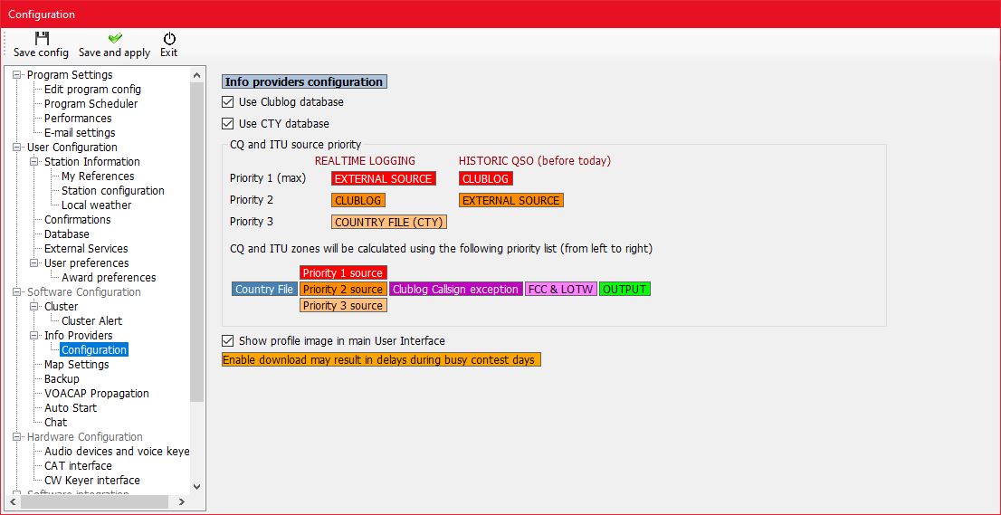

The middle of country issue was major issue we were having and the ability to set the Info Providers/Configuration was causing most of the problem. Ergo, Lele changed that panel and removed the fully customizable options of sort order, etc.. That was noted with Versions 2.24 and 2.25

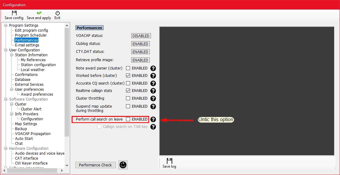

I've added my Configuration/Preferences page below and am wondering if the "Perform call search on leave" will make any difference for you. I've tried it on/off and also with the Callsign search on TAB on/off, but could not tell any difference for me.

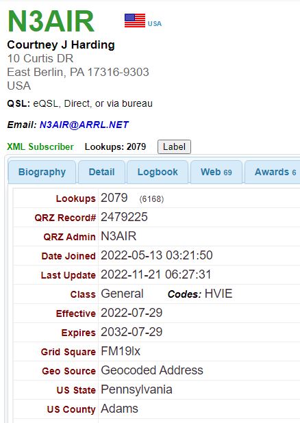

One more thing ... do you have at least an XML Data Subscriber membership at QRZ.com? Your profile page does not indicate that you are a member of any level at QRZ.com ... Albeit sometimes OMs are members and for some reason it does not show up in their profile page.
With at least an XML membership the data one gets is the full bore of information. If not (at least an XML member) the data received is minimal at best and does only include 4-digt grids, etc., etc..
That may also be part of the issue, but if you have an XML Data Membership then we still need to continue digging.
