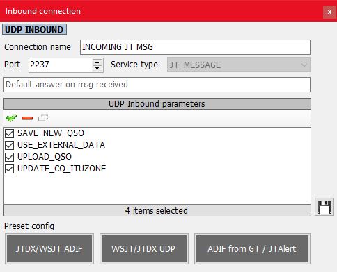

What options do you have selected on your UDP Inbound Ports ?ve3wej wrote: 10 Sep 2023, 22:46 I have qrz.com, eqsl and clublog to upload ( delayed ), but they are not sending. If I go to utilities and start the uploads in that window, it will upload. I did not notice when it started, currently on beta 2.28.0.8.

I have added that and I will see, even if I dont understand what inbound has to do with sending to externals.

Are the QSOs coming into your Log4OM from an FTxx APP?ve3wej wrote: 11 Sep 2023, 14:20 I have added that and I will see, even if I dont understand what inbound has to do with sending to externals.
we will advise if it works
These settings directly affect how the FTxx QSOs are handled.

ok, I added as your screen shot, restarted log4om, and no auto upload.

I'm going to assume that after you installed Log4OM V 2.27.1.0 where there were substantial changes made to the UDP Inbound configuration that you noted the Release Notes and deleted and rebuilt your UDP Inbound Connections so they would work with that new release.

well, between playing with the udp additions, and up/or upgrading to 2.29 uploads are working again. Thanks for the help

Thanks for getting to the bottom of this. I had the same problem when I updated to v2.28 so I rolled back to the previous version. I then updated again when 2.29 was released and again, the same thing happened. Similarly, it would not pre-populate the Operator's details from QRZ using the look-up.
Following the above steps to reselect the UDP options fixed it for me. I'm so relieved.
