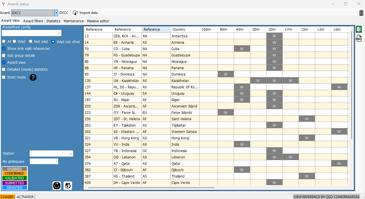

WA1SXK's log link. When we select "Wkd not cfmd" for DXCC it shows nothing where there are worked-not-confirmed entries in the "All" view.
Hasn't worked on his log for quite a while so it's not just the new version.

2.29.0.0. wkd not cfmd not working

I figured out the "problem".
He doesn't have any DXCC single entity that is "Wkd not cfmd".
He does have ones for 5BAND or Challenge that have worked only on some bands.
But there doesn't seem to be a mechanism to set up the 5BAND or Challenge award to require all bands checked/satisfied to filter out what's needed.
