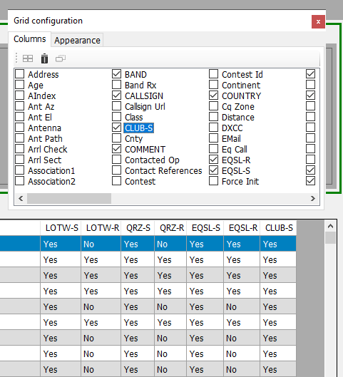

Configuring the QSO View(F7) Screen with "Grid Configuration"
I'm missing an element to add on the view...
I have added [X] , Removed [ ] and renamed various elements.
But there "is" no option for [X] Club Log Received, there "is" a [X] Club Log Sent option. (remaned to "CLUB-S")
Any advice..??
Thank... Dave ~ G8LIY

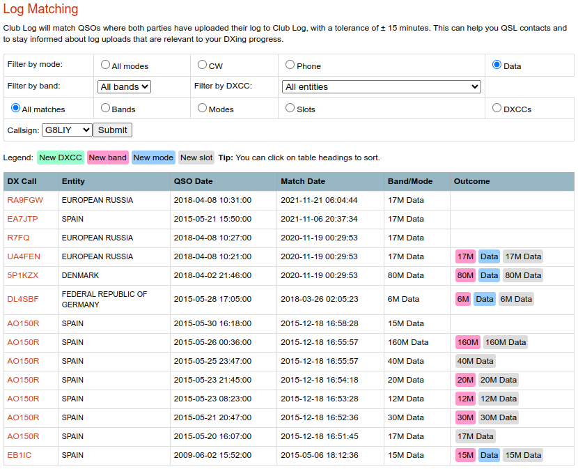

I'm not asking for LOG4OM to Automatically Download directly from Clublog
I want to import the adif file that is downloaded from Clublog to get the Confirmations
I understand Downloads from Clublog are manual, there is a button to do it.
- clublog.png (65.62 KiB) Viewed 1864 times
- Clublog-2.png (117.49 KiB) Viewed 1864 times

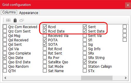

As for the Sent/Received columns ... I use the columns that are adjacent to the Sent Date / Received Date. Those columns appear in all the external sources no matter the source I choose. IE: LOTW, Clublog, QSL, etc..
I've relabeled the columns as well.
Note image below that shows the two columns I use for my installation.
Ergo ... for whatever reason I don't use the columns in my grid that are already labeled for the source.
You could add those columns and label as you need and see what it presents you. I think it will work FB, but give it a test and see.
I've added the LOTW specific columns for a test and it appears they show the same data as the general ones I've been using for many years. See image below for my test.

- QSLMngrGrid-1.JPG (183.21 KiB) Viewed 1840 times
- QSLMngrGrid.JPG (31.29 KiB) Viewed 1840 times

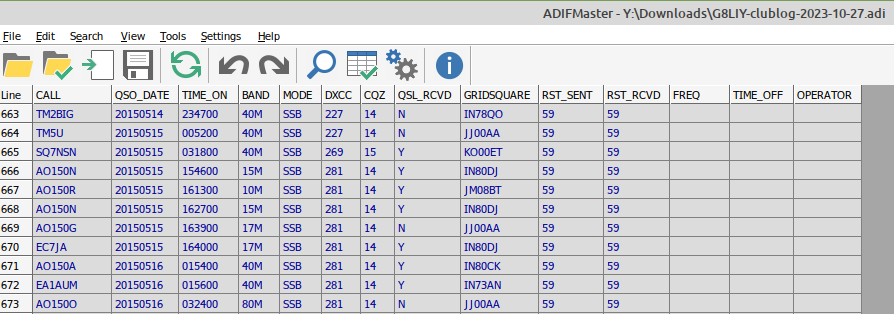

per my screenshot I already have LoTW S & R and eQSL S & R and QRZ S & R and Clublog S,,, Clublog "R" is simply missing.
Clublog provide the data QSL_RCVD = "Y" when there are QSO matches,
It is in the ADIF, download Settings > Callsign
- CLUBLOG-ADIF.png (56.02 KiB) Viewed 1766 times
